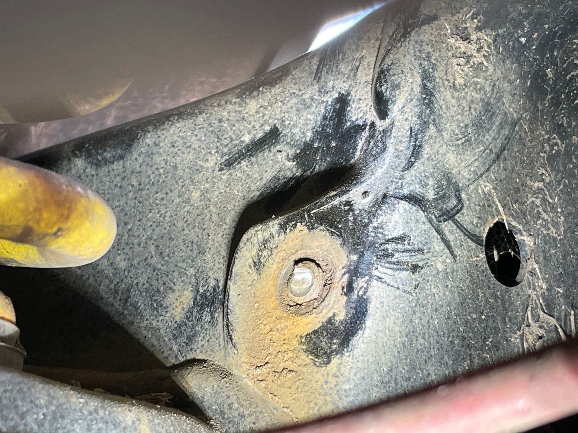

Swaybar link bolt snapped
This has snapped 07119908026 Hexalobular socket screw
so do I need a new trailing arm ?
or can I rivnut it ?
33308842878
Or
33 30 8 854 116
or would you try and drill it out, or attempt to rivnut it ?

That sucks!
Got access to a MIG welder? Weld a nut to it. otherwise drill, and if need be, install a helicoil.
Guessing that attempting to extract is less hassle than replacing the arm.
I'm a bit wary of the rivnut approach - no experience with them
Allmag has clean used arms, no affiliation, just a satisfied customer
Best of luck!

Drill and try to extract. Something like this should work.
https://www.ecstuning.com/b-titan-pa.../ttn16013~ttn/

If you go the drill/extract route, I would strongly suggest getting a center punch, so the drill stays in the center of the screw you are trying to extract. Also, start with a much smaller bit first to drill a pilot hole and step up to the final size for the extractor bit. Good luck!

Man with welding kit and talent sorted it for me
