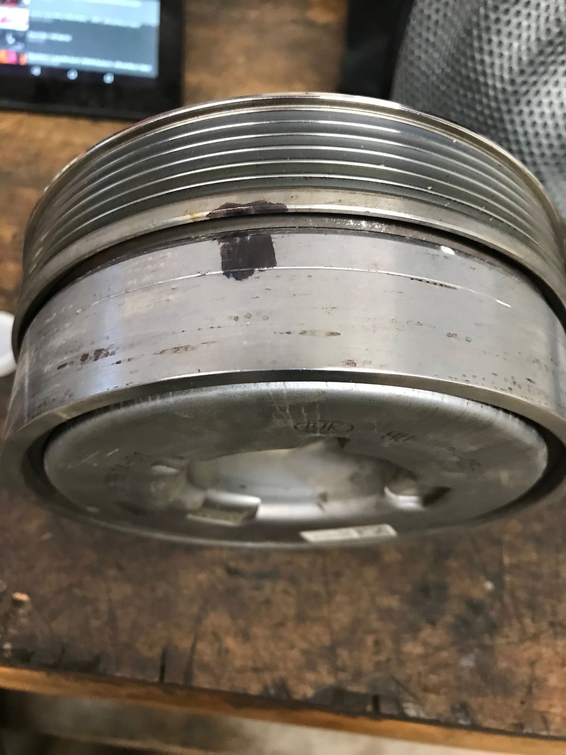

Replaced a 3rd one today. This MINI has 175K on it. Belt was still spinning, but wasn't charging and overheated. I was able to make pulley slip by hand. It was a little noisy.

Thanks for letting us know about this, what do they look like after you take them off?
Old Jan 3, 2019 | 08:27 AM
Captain Kirk's Avatar
Captain Kirk
Joined: Apr 2018
Posts: 17
From: California
They look normal. They don't break into 2 pieces like the R53s. The first 2 I saw fail, the pulley that drives the belt was spinning freely. The mass bolted to the crankshaft was spinning, but the belt pulley would not spin. The 3rd one, it was not totally free, it had about 20 degrees of free rotation. The main issue was a failed alternator, but I discovered the crank pulley was on its way out and replaced it also. This one was also noisy, I am guessing from it slipping back and forth and not totally failed.
Marked the pulley
Looks normal
Marks have moved.
