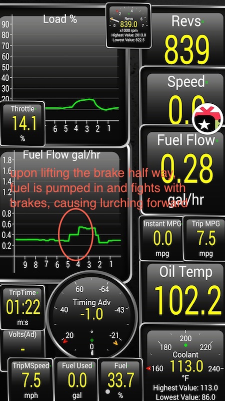

When I'm in "D" and stopped with brake pressed all the way, the engine is idle and using 0.29 gal/hour gas. As I lift my foot off the brakes just slightly, the gas usage surges to 0.5 gal/hour and the engine fights with my brakes making the car try to lurch forward and it is very uncomfortable causing vibrations and all. Normal Mode, Green Mode all does this.

Edit: I have added a screen capture of me using only the brakes. Not even touching the accelerator pedal. You can see in the Fuel Flow gal/hour graph, there's a blip that goes up to around 0.5 gal/hr rate, causing the car to lurch forward fighting the brakes. This makes it very hard to only move couple inches forward from a complete stop when needed (brake pressed all the way).
