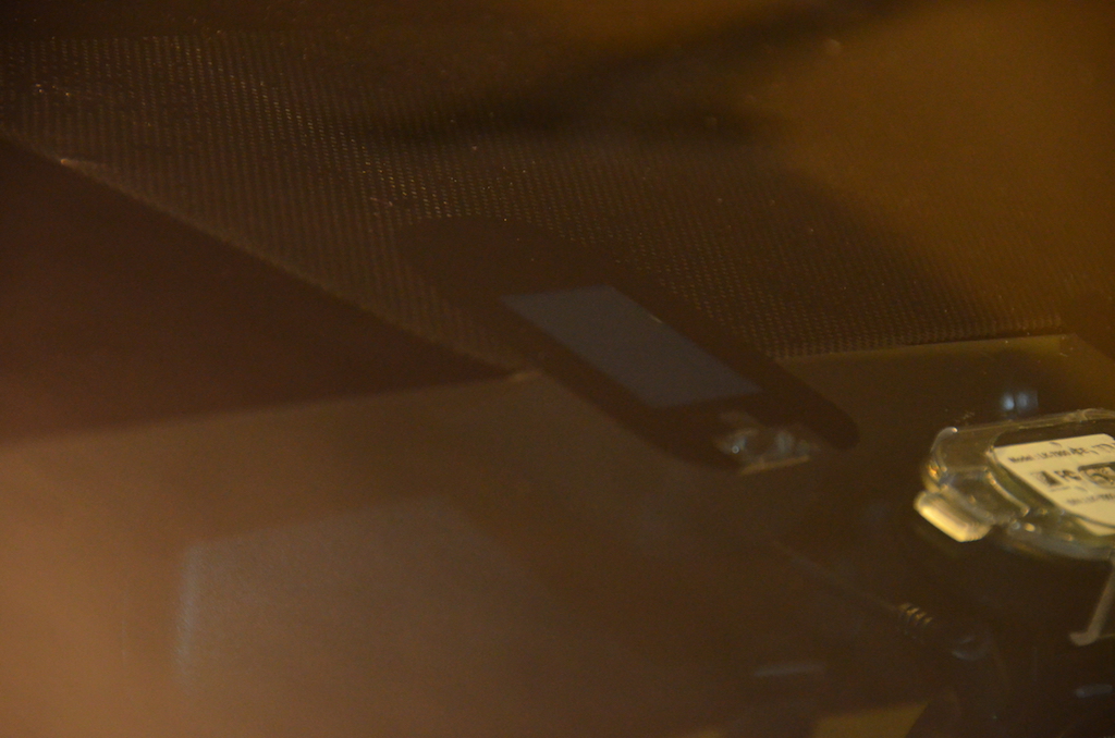

Looks like it was the gel pack for the sensor and not the auto dimming glass fluid like on older 7 ser BMW' s.
http://www.realoem.com/bmw/enUS/show...diagId=61_3297
What was the part number for the gel pack ?

Thanks for the pic.
If this is bad by design, it's going to happen again in the future. I can clearly see air bubbles in that sensor spot now that few drips of the gel has leaked out.
I'll have to book a trip to the dealer.

I replaced my rain sensor on my 2015 F56 for the fourth time now and I'm not even surprised that it's doing the same thing again. I drove maybe 100 miles since last replacement, and was parked in my garage that's around 20C all the time. It's the base mirror, not the automatic dimming mirror.
I even see that there's air inside the sensor gel pack area, where I think it should be completely filled with the gel and with no air.
Can anyone check if theirs is completely filled, packed with gel?
Attachments - Photo of the air pockets on the MINI, and a second photo of my 2014 Mazda CX-5 rain sensor with no problems.
