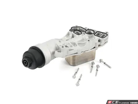

A known weak area is the oil filter housing, (yep, plastic). plastic breaks around the mating surface gaskets requiring replacement. Plenty of info on the forums. There is a metal part available.
ES#4623857 - 11428585235M - Oil Filter Housing W/ Cover - Upgraded Metal Version - Replace your cracked or leaking housing - Bremmen Parts - BMW MINI

Interesting that you say that, because I was just about to explore what it means if I'm seeing lots of wetness around the oil filter housing and the bottom of the oil pan (and a sensor that I can only assume is that %#@$! oil level sensor that robbed us of a dipstick and therefore the ability to check level while changing the oil), but I'm not seeing wetness above it - and not seeing wetness below the radiator or hose:
And the hairy cardboard engine cover was ludicrously saturated as you can see , and also I saw residual wetness right near "directly underneath", as well as my spotting some drips here on the ground after removing the panel and adding coolant again:
Seems a likely culprit. 🧐

ECS carries the Bremman Parts metal replacement oil filter housing, BUT>>>>>>>>>>>>>>> it looks to out of stock till August. I guess search the net.Mfg Part #11428585235MECS Part #ES#4623857BrandBremmen Parts

I also found this one, and at least according to ChatGPT these part numbers DO cross with my car:
$228 is nearly double what the Bremmen one costs at ECS, but I can get it now: https://www.bimmerworld.com/Engine/B...m-B46-B48.html
We'll see if any Ebay listings offer next-day shipping. I'm seeing listings on there for $60-$120, which is way cheaper than this one. Unfortunate that I need it quick.
I did decide to also order the HICU water pump with the metal impeller, and a thermostat since 60K seems to be about when it should be replaced anyway - and since it is plastic and I'll have everything apart, it's the right time to do it.
Fingers crossed I can get a metal housing by Tuesday so I can make this a one-and-done.

This looks like a safe bet. In stock in NJ
NEW Oil Filter Housing & Cooler FIT BMW 2.0T 2016-20 X1 X2 Cooper 11428585235 | eBay

I did actually order the plastic one of your house brand, and also a new thermostat, and also a new water pump - the one with the metal impeller. And new intake manifold seals since I'll pull that ...and a coolant refill tool to help refill without air pockets.
I did find an aluminum oil filler housing from an eBay vendor, so we'll see how that looks - with luck it'll be good enough so I can use that rather than the plastic one, and make this a "one and done" job. I want this car to be reliable through some more above-and-below freezing fluctuating winters here.

So the eBay aluminum one showed up and it looks decent.
At least at first glance. Was packaged well, gaskets and hardware included and protected.
Fingers crossed.

I also rented a pressure tester, and did a crazy kludge to make it work from the overflow - I'm not sharing that pic, and I almost got the rubber fitting that I inverted permanently stuck in the overflow bottle... But I got more coolant to leak, and it did seem to confirm it's coming from this oil fill housing.
I didn't see a specific leak "point" but this whole thing was wet - tough to photograph, but that's what the red arrow is pointing to
I drew the blue arrow just so you can see this is the oil filter assembly - that's the oil cooler, the rectangular part of the assembly:
I'll have it off tonight, and we'll see what it looks like.
