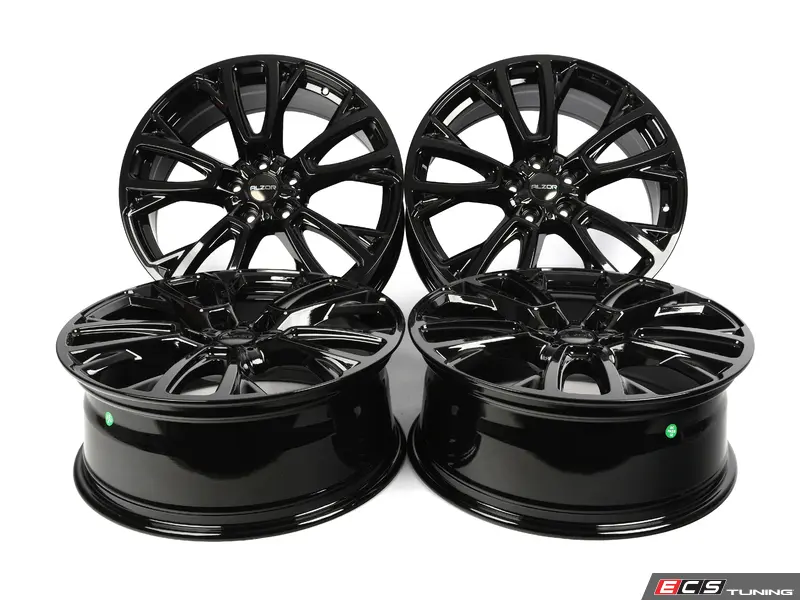

WTB: JCW Circuit Spoke 592
I'm looking for a set of JCW Circuit Spoke 592 19 inch wheels for a facelift F54 JCW Clubman. Any one have some they're trying to get rid of?

Hello,
We just landed some new alzor wheels in that OEM design. Which we have not emailed/launched yet on social. 19"x7.5" so they are 1/2" more narrow then the stock wheel so they can clear more lowered cars in the F55-F57 Platform.
Gives you another option. These also fit the MINI factory center cars for F54-F55-F56 F57 F60
https://www.ecstuning.com/Search/SiteSearch/592_19%22/

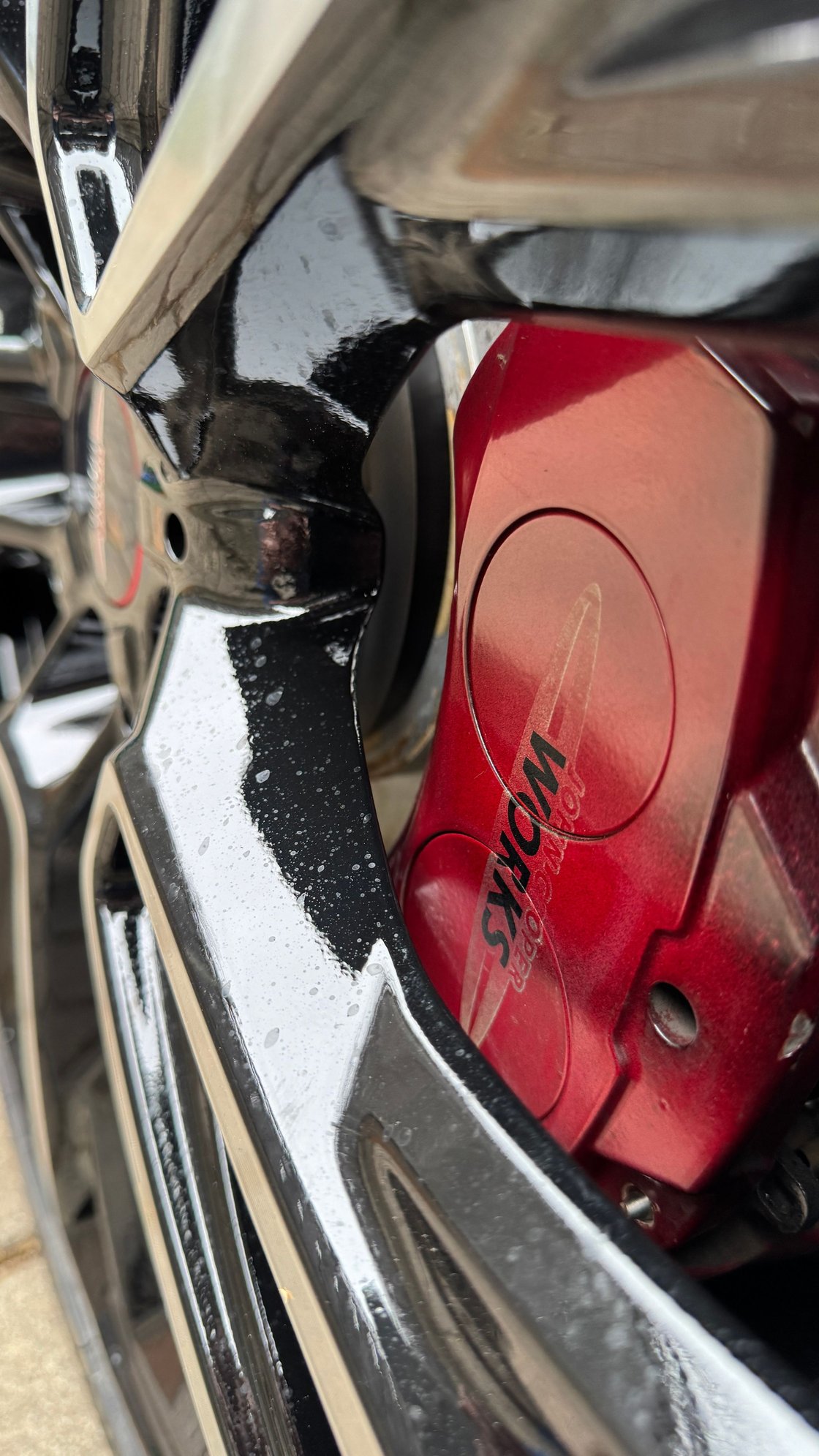

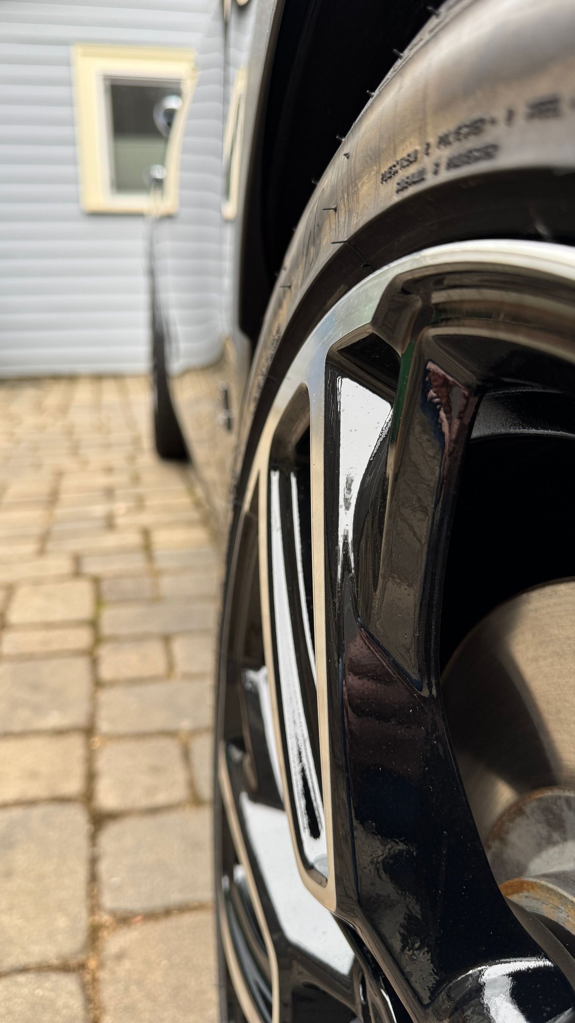

I thought I'd update this thread, to close it out.
I went ahead and bought a set of the wheels from ECS Tuning, and had them (and new tires) fitted today.
My only regret is that I listened to Tire Rack and went with a 225/40/19 sized tire when I should have listened to ECS and went with their suggested 235/35/19 sized tire - the extra width would have brought with it a little bit more rim protection, but the Bridgestone Potenza RE980AS+ I wanted to use weren't available in 235/35/19 anyway.
I did need to use 12mm spacers in order for the front wheels to clear the JCW caliper - and went for those spacers all round. Photos embedded below.
