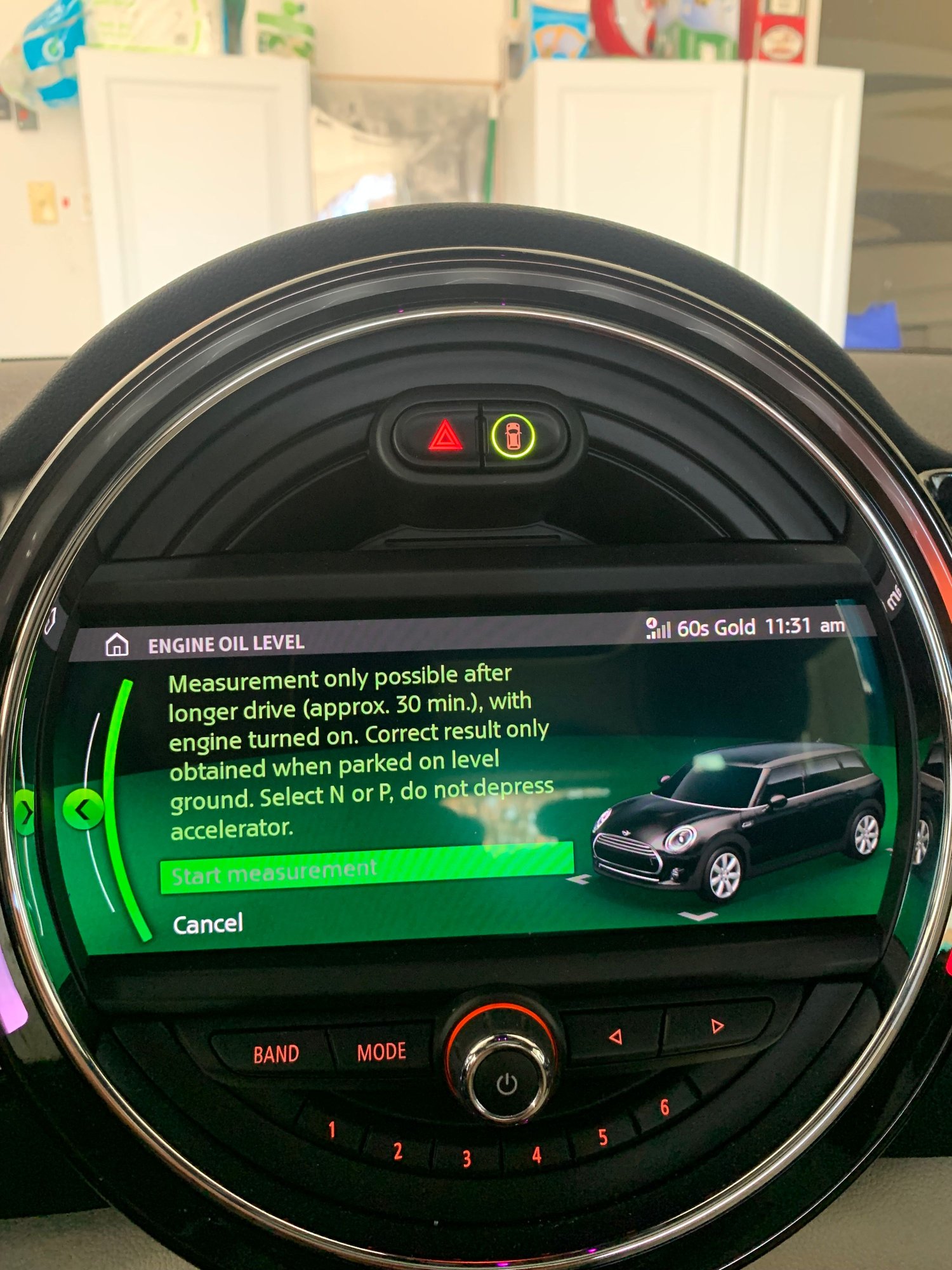

Old Dec 29, 2024 | 11:31 AM
geolemon's Avatar
geolemon
Joined: Jun 2022
Posts: 271
Likes: 55
From: Buffalo, NY
So after an uncomfortable number of days (and also having remembered after one random commute to the office having nothing to do with an oil change), I think this was my fourth attempt to "measure level", and this time I found the option was available:
I was glad to see that with having added just 5 quarts, it was at the "maximum" level.
However, that may also be partially explained because I wasn't able to change the oil filter this time - the 32mm socket I had was too deep. I have since purchased a shallow one that can fit behind the metal that blocks it, but that'll have to wait for next oil change. So I'll be doing an early oil change in the spring and THEN we'll see if 5 quarts is still the right amount...
...but I have a feeling this whole "drive around uncertain of the actual oil level" is going to be a thing next time, too.

Drive with that screen open and when the box highlights, pull over and check the oil. As I mentioned above 3.7 miles in my car.

It's an interesting suggestion.
I don't know if the unfortunate timing of my oil change with the winter temperatures played a factor, of if it was because I let the car idle for 5 minutes.... 10 minutes... 20 minutes rather than driving it was the issue.
Eventually I did have to give up and just drive the car to work, and my commute is just shy of 20 miles. I didn't immediately get to check after the first two commutes, but I optimistically thought there something that reset - "OK - has driven enough to check", that next time I got the engine warmed up, it would be available. Nope.
I'll have to see in the spring when I can re-try now that I have my new low-profile 32mm I'll be changing it sooner than "3000 miles". I'll see if I actually drive it around with the screen up, if it does what you say.
I can't imagine an oil change place, what they must think...It really just seems like something BMW didn't think through. So odd, all inconvenience and risk with no plausible benefit.
