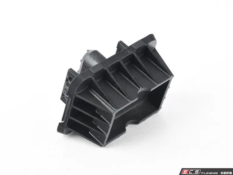

I would jack it from the normal points on the side near the rocker. Also that way you can drop that front pan if needed.
https://www.northamericanmotoring.co...rt-number.html
Jack points and part number.

Yep i would not jack on that mid point, might bend it. Can you get it from the rear jack point, i think its center rear, check the owners manual as the picture i have is for the F55 F56, not the F54 or F60
Or
Also maybe some ramps to get it up to slide them under?
https://www.northamericanmotoring.co...ck-points.html
