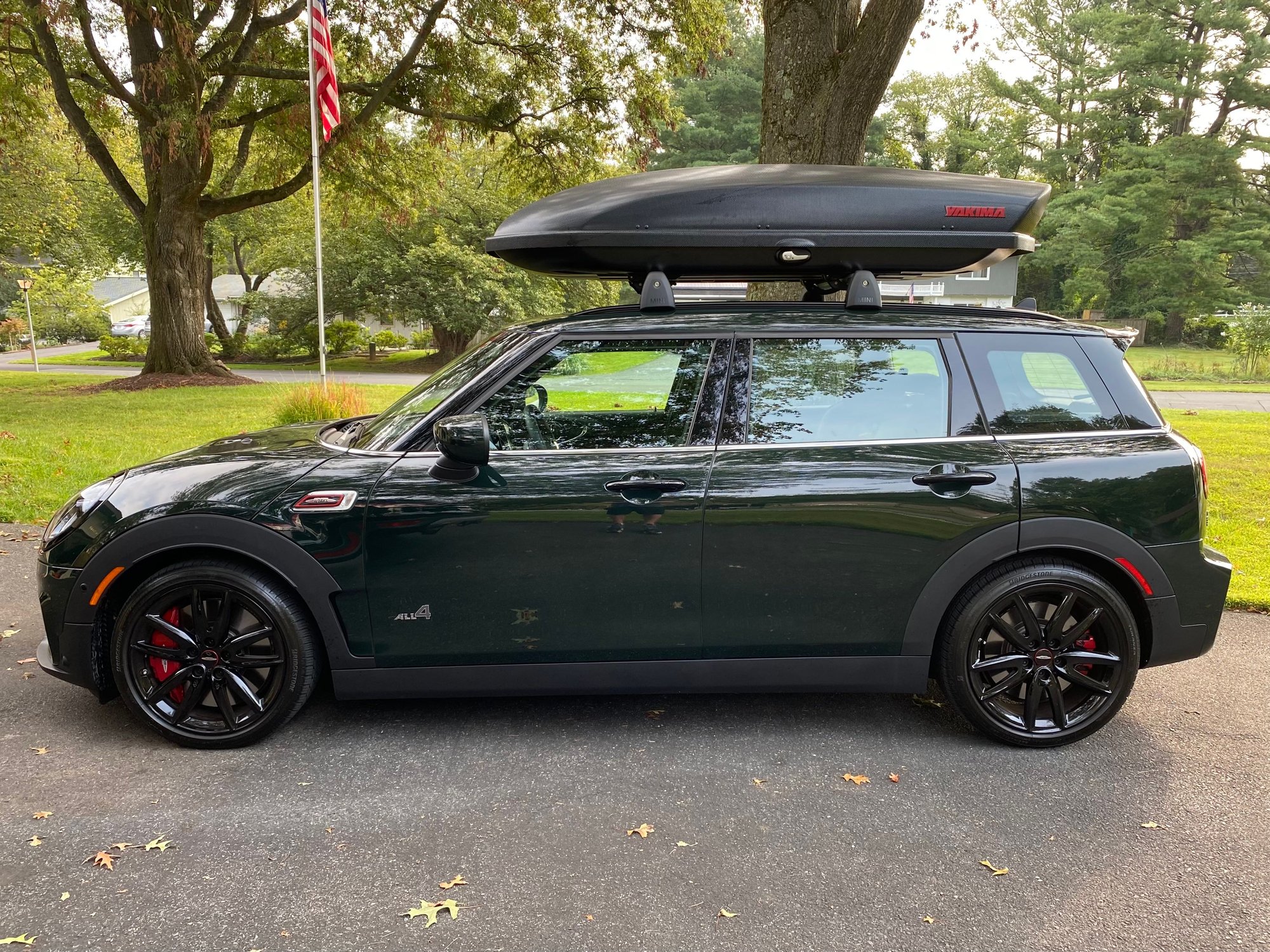

This is how mine are currently:

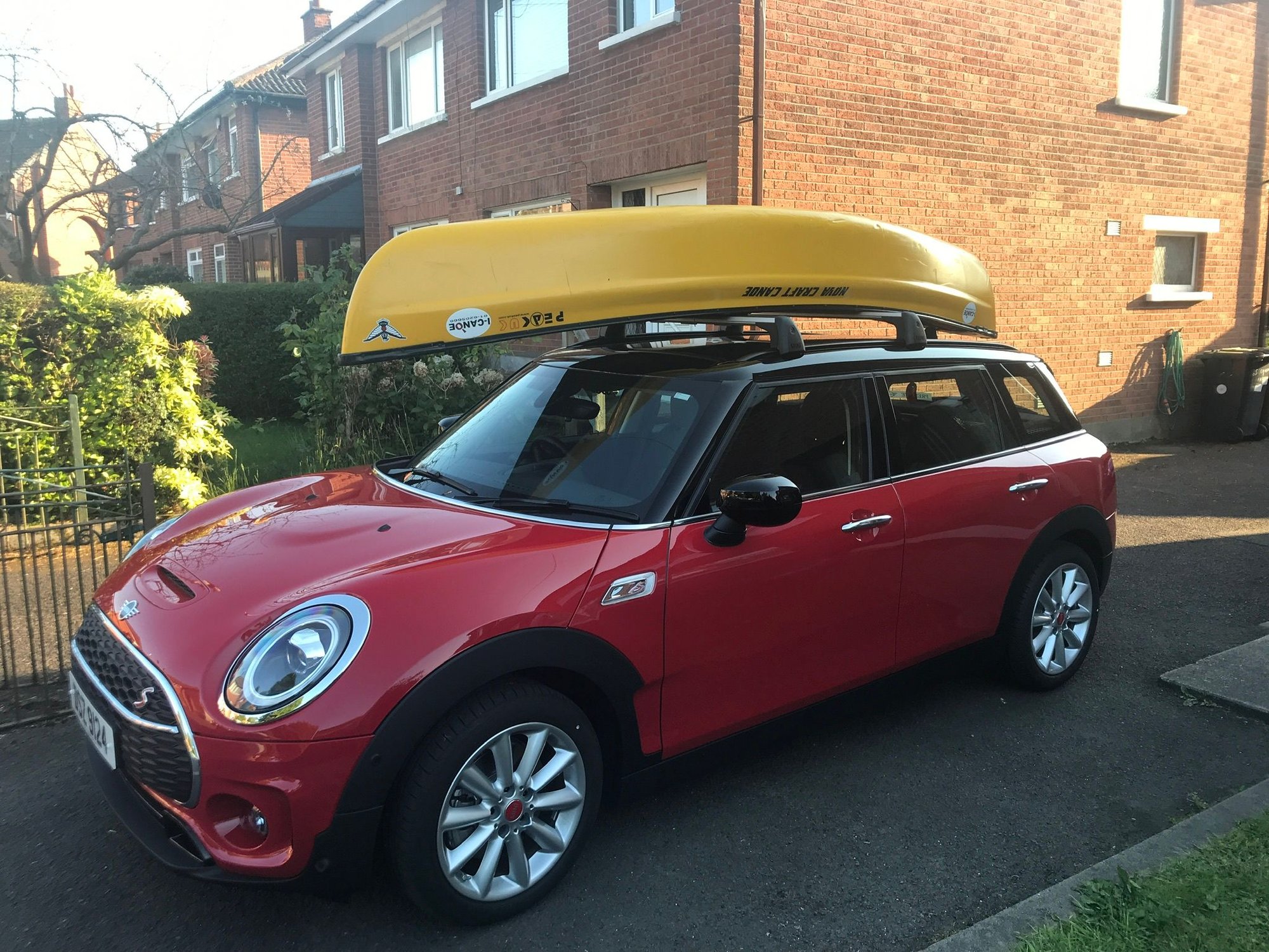

Hi, I have mine according to the manual and I to have always thought that they looked quite far forward.
I have used it for the roof box as well as carrying kayaks and canoes and so far no issues.

I ended up adjusting the box forward a bit on the cross bars today instead of messing with the cross bar placement itself. I’m pretty
happy with it and now the load looks like it will be carried more evenly.
I think originally the long flat roof was just messing with me as I felt like things should be further back. Looking at the placement of the cross bars, it seems like they apply the weight to the same area of the car where passenger weight is applied. I’m sure that helps distribute between the axles where it was designed to be. But a lot of bars have a 700mm spacing requirement, so I assume that compatibility with accessories comes into play on that spec.

I made one more change this morning. I moved the front rail back to be 250mm from the front edge of the rail to the front edge of the plastic base like you have yours. The manual says 250mm from front of rail to center of base, but I think this is close enough to that and I have seen MINI videos where they measure rail to base like you have yours. I moved the rear bar back to still be 700mm center to center on the rails, so still maybe a few inches closer than your current setup.
Since so many rack manufacturers use 700mm spacing regardless of the car, I’m thinking that number has less to do with the specific roof and load bearing and more to do with accessories or something. Anyhow, I also adjusted the box on its tracks to move about 2 inches back, so the box is about 4 inches further back overall.
I thought about moving the rear bar back even more than the 700mm center to center, but the rail looks like it starts to slope down a bit more drastically and didn’t want the mess with the box angle too much. I think it’s a nice improvement overall and any further back would start to cover the rear antenna.

Okay okay, I swear this is my last adjustment, I do need to work today. Kept the front 250mm from front of rail to front of base, but slid the rear bar to have 700mm between the bars instead of center to center, this added another 2 inches or so of spacing. I used that extra space to slide the box back a bit further.
I think this is still within a reasonable amount of the manual instructions and I have to imagine the rails wouldn’t have the adjustability if they couldn’t handle different positions.

It looks well balanced, visually and in terms of weight distribution. The rails aren’t rated to hold much so once you factor in the weight of the box, you certainly won’t be loading bricks in there.
The Yakima box has a nice silhouette. The texture and color matches the arches well, and the logo is a nice call back of red. I’m starting to think that wasn’t an accident.
