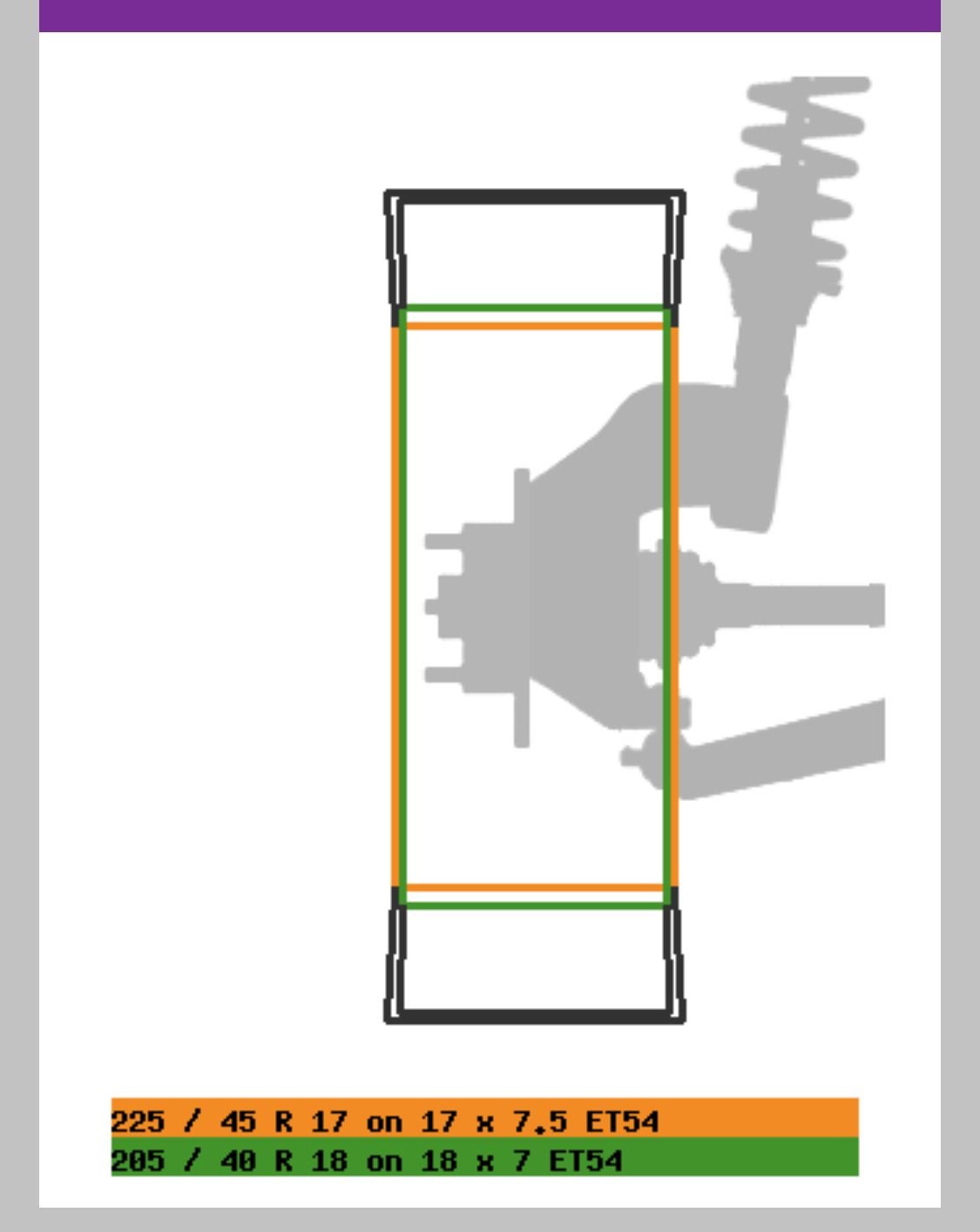

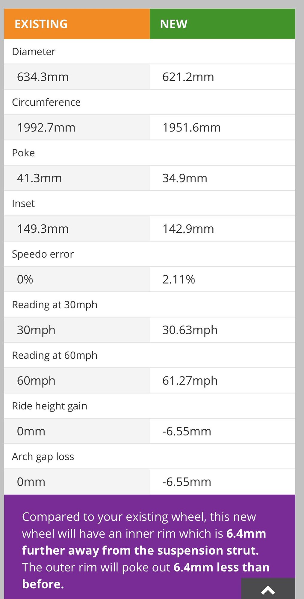

Great price and they look really nice. The rim width is 7” if they came of an f55. It will have a smaller contact patch but the overall diameter is what you’d look. The rims are 18” but the tires for a clubman are 225 stock (205 for a cooper).
225 would be the widest tires you can put on a 7” wheel. Not sure if they will rub, but spacers should get them out to sit flush. Check out ‘willtheyfit.com’ for the diameters of stock vs.your current set up.’
assuming your stock wheels were 17”, this is what you’re looking at. New 215 or 225 tires would correct that diameter, 7mm-15mm spacers will push it out
