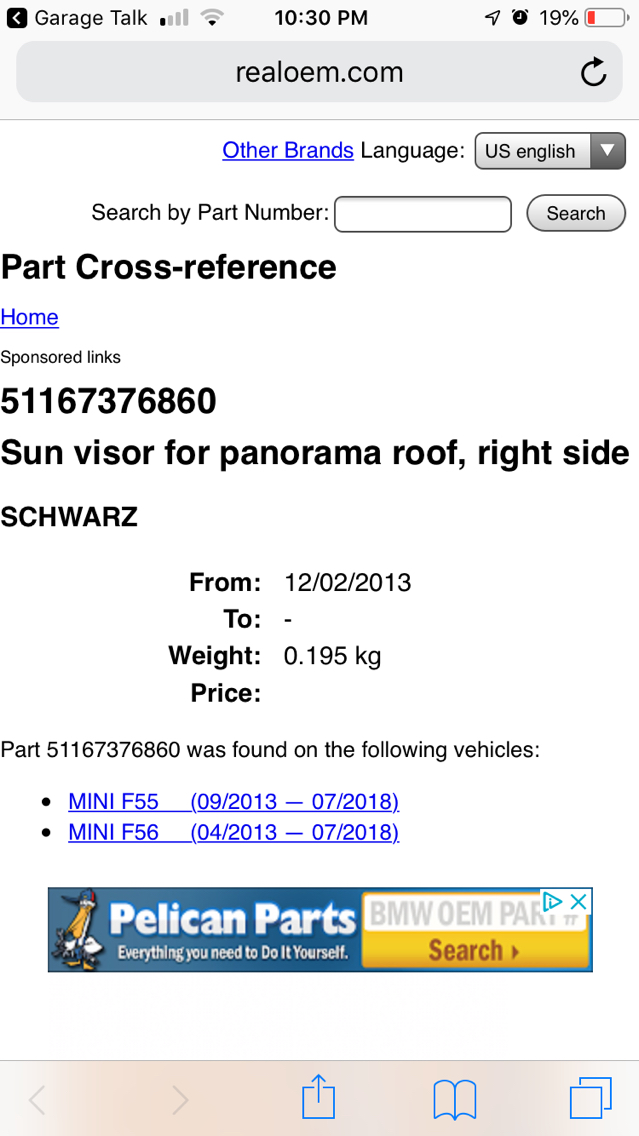

Please checkout PN: 51167376860 Sun visor for panorama roof, right side: http://www.realoem.com/bmw/enUS/partxref?q=51167376860
Right. What am I missing? That part applies to F55 and F56, not F54.
My F54 must be an F55 or F56. Or they are the same sized holes. I give up, I will leave it up to the LHD braintrusts to work it all out for RHD.

Okay, this thread has been eating at me, so I did a little bit more research. I owe Eric Avatar an apology -- sorry for doubting you.
I'm still pretty certain that no F54 ever came from the factory with a right-side visor.
But the left side visors are the same between all of F54/F55/F56, so it is reasonable to assume that the F55/F56 right side visors will fit F54 just fine, and presumably would always be symmetric with the left side.
Which means that Eric has exactly the correct part for his car. For cars without the panoramic roof, the correct part number is 51167375954.
That's for anthracite. Space gray headliners have different part numbers, which I'll look up when I'm back on a real computer.
