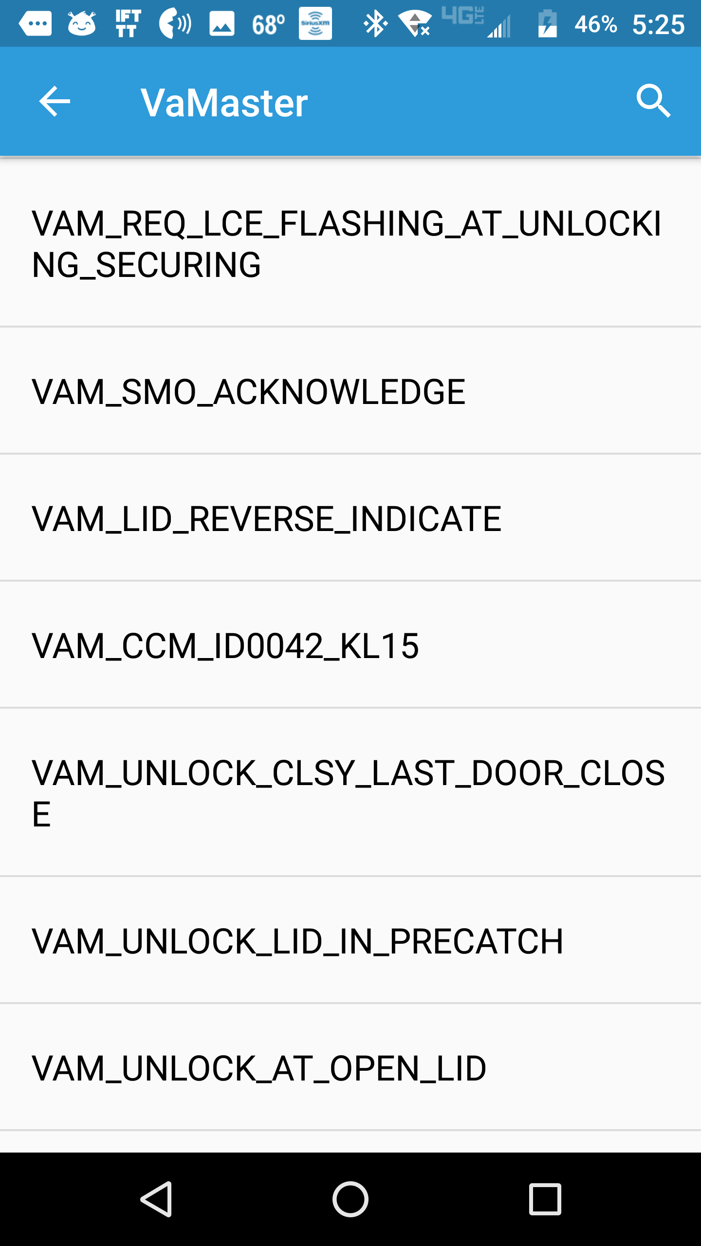

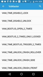

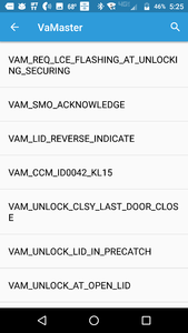

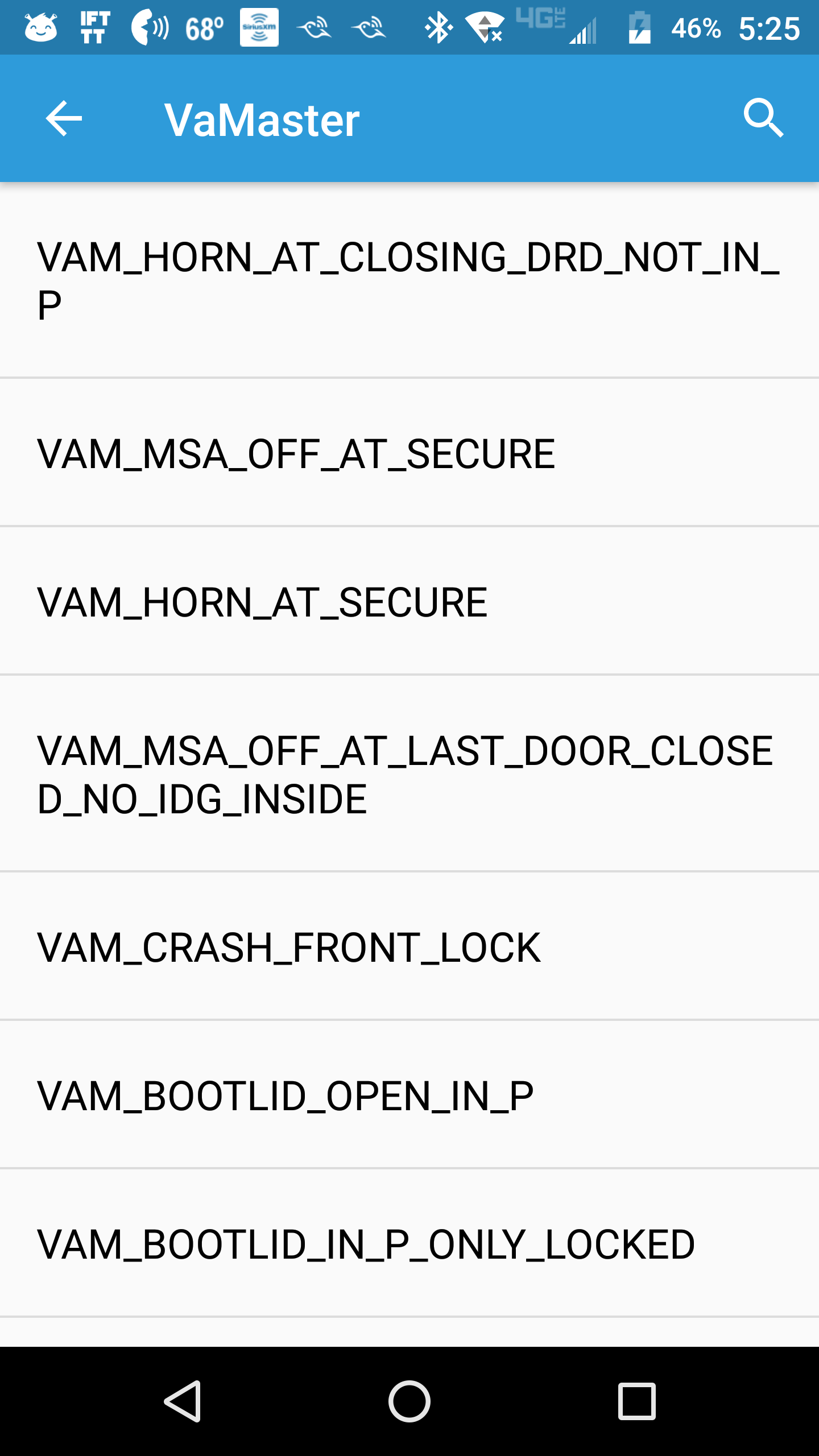

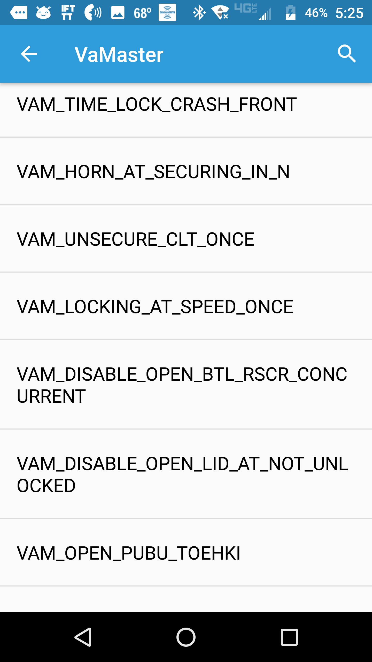

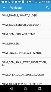

Originally Posted by siriuszero
They did change the parameter on newer software versions so the coding is different. I had to find the right thing to change when I had a software update done on my F55 and again when I bought my Connected 5.0 equipped Clubman. Haven't seen a 2018 model though...
It will be one of these in the BDC - change to "aktiv":
VAM_UNLOCK_KL15OFF_AFTER_PIA_AUTO_LOCK
CLI_DEFAULT_UNLOCK_AFTER_END_OF_DRIVING
CLM_UNLOCK_KL15OFF_AFTER_PIA_AUTO_LOCK
I'm not seeing any of these. This is everything under 3040. There's one that has KL15, but it's already listed as aktiv.
Attached Thumbnails Bimmercode app-code-1.png   Bimmercode app-code-2.png   Bimmercode app-code-3.png   Bimmercode app-code-4.png   Bimmercode app-code-5.png
