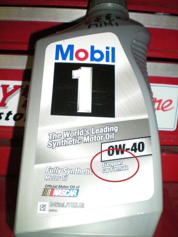

I've not had a GEN3 so maybe something has changed but my 1 & 2's all called for full synth 0-30
I get oil from parts stores or Wally World (when on sale)
all you need is the proper weight and '100% synthetic' and you are good to go. nothing special about "MINI oil"
and if you are gonna ignore the manufacturer recommendations and change that often you don't even need the good stuff ... 100% synth' and very high duty rating is required to achieve the long interval.
I've been using Mobil 1 0W-40 "European" in my MINIs since 2002 and once out of pre-paid maint' changing when the computers says to with no ill result and never had an 'oil consumption issue' either. But if it helps you sleep at night the oil sellers love you.
