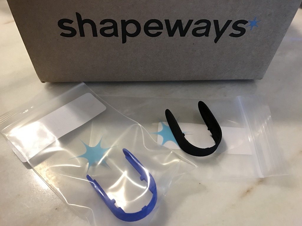

Then got fed up with the key size so set about making and printing one, I went black in the end - then someone said that someone else was doing the same, thought I had come up with something different :cursing:

BTW- thanks for the key-shrink! When I am back in town, I'll share some pics of them on my key.
