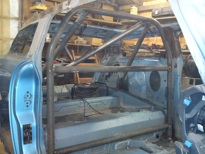

The months went by and I worked slowly on the project making sure I did it all correctly. Eventually I got to the chop and it went well
cage went in

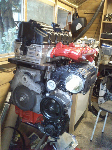

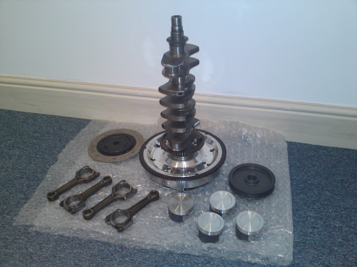

Engine got built

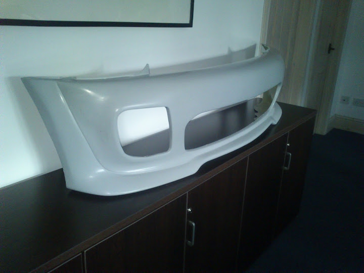

Bumper got made
