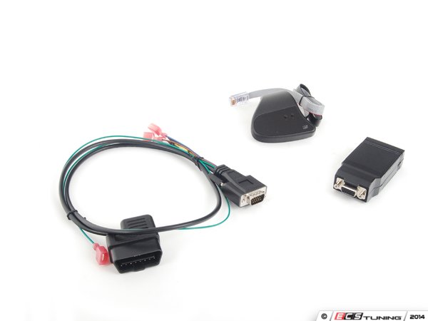

I installed the P3 gauge about 2 months ago. Very easy to read and covers just about everything that you need. A little costly but installs in less then 1/2 hour and looks great.

Could you post a link to where you got it. I'm curious what guages you guys think I need. I want to have the information I need to make sure my car is within safe parameters. What is a good Bluetooth obd2 scan tool and how much less accurate are they. Will is show afr

The P3 gauge is sold by many of the aftermarket suppliers that post on this site. They are not cheap but cheaper then purchasing the factory setup. I tried the Scan gauge 2 but the font is too small for my eyes. The P3 is perfect as i had one in my VW GTI for quite a few years.

+1 on the p3cars gauges, reads and clears codes, plug and play, digital ( very fast ). Fits into the dash, by the tach.
http://www.ecstuning.com/Search/SiteSearch/P3M58L/

I looked it up and that is really cool. One of the main reasons that i need it though is for the AFR. From some of the videos that i watched i didn't see that function like i did in the Scan Gauge 2. Is it possible. I like that one a lot more although the Scan Gauge 2 shows more at once.
