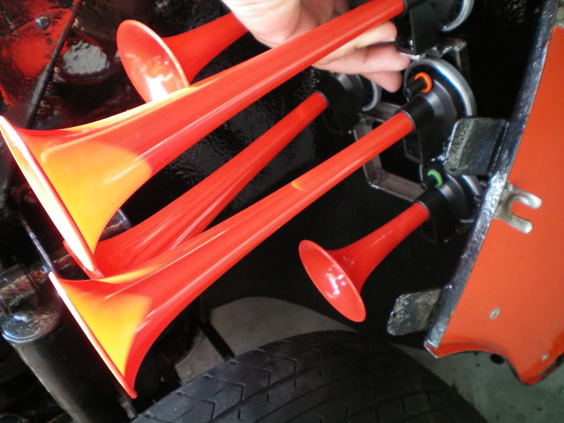

I just spin off the connector and expose the two wires (a hot and a ground), crimp on simple connectors and plug the wires to the horns. Easy! A little heat shrink or paint on insulation helps keep everything water tight.
Now if you want some serious horns, this is what I put in my 79
