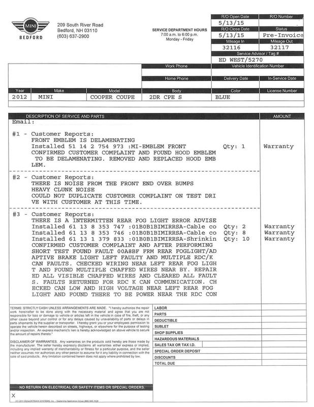

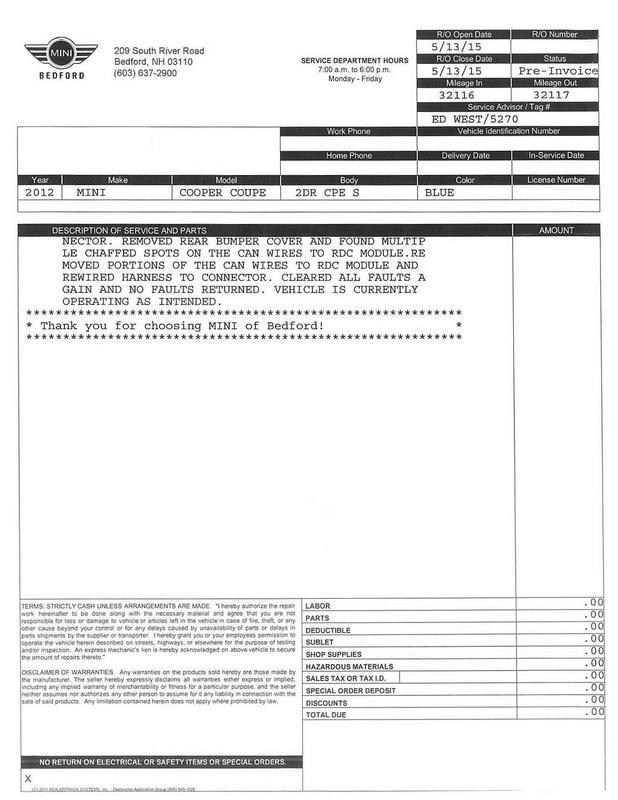

Just an update on this thread. I too had the intermittent bulb indicator. Mine was the rear foglight indicator. I was at the dealership for other reasons, and mentioned it to them. Then ended up having my car for over 4 hours, tearing the back bumper off to get to some frayed wiring up behind it. Turns out that the wiring back there is tight, and rubs, causing a fraying condition where it's ground out to it's mounts or on the frame/suspension.
If you want, i'll scan in my repair order which has part numbers, etc.

Attached is the RO, both pages.
Funny, when I started Stuart this morning, he popped a light for an exterior bulb being out. lovely.
