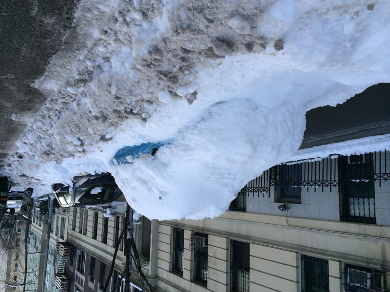

After being slammed with two big snow storms, I had to dig out. The battery died a week before but I removed and charged it and my car worked fine. Then bam, snow snow snow, as the pic suggests. 1.5hrs of digging later and my chariot is free only to have a bunch of oddities. The Check Engine soon light, brake light and one next to it are on nearly all the time aaaaaand my Traction control light and tire pressure lights are on as well. But the biggie is that neither my analog speedometer or my digi speedometer work. The needle just sits there laughing at me ... not moving. Any ideas?
