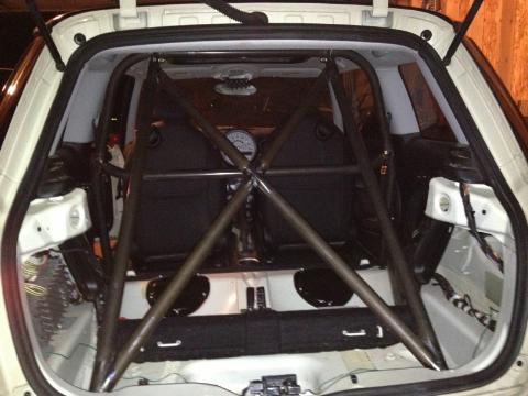

good info ya adding another 15lbs of cable would kind of defeat the purpose, i want to get the car as light as possible and balanced but at the same time keep it a nice car, by this i men i still want my power steering pump and i still need ac in the summer lol im already sacrificing my heated seats for the Corbeau's but i don’t really drive the car when its under 55 out anyway so i should be fine. I don’t want to rip out the head liner and destroy the car just in case I decide to re-sell it down the road. Her eis a pic of the back so far the Corbeau's should be in this weekend.

So you caged the car and are putting in aftermarket seats that together are not cheap. Yet you are up in arms over spending $177 dollars on a light weight battery. Okay cool man good luck

porthos, I gotta pinch every penny that’s how i can afford to get all the stuff i want in the car along with working a full time job and running a small side business to scrape by, i just feel the roll bar and seats are a necessity for full track driving even if its just HPDE for safety
