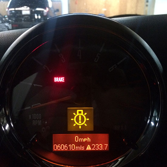

Sorry to stray from the new datens conversation... but I'm looking for a way to disable the rear fog bulb warnings. Long story short I had rear fogs now I don't and I need to disable to bulb warnings.
I have this warning dash light:
NSL_EINSEITIG_VERBAUT_C34 nicht_aktiv
KALTUE_NSL_L_M2_51 nicht_aktiv
WARMUE_NSL_L_M2_51 nicht_aktiv
CC_MELDUNG_NSL_L_3R wert_02
KALTUE_NSL_R_M1_10 nicht_aktiv
WARMUE_NSL_R_M1_10 nicht_aktiv
CC_MELDUNG_NSL_R_3R wert_02

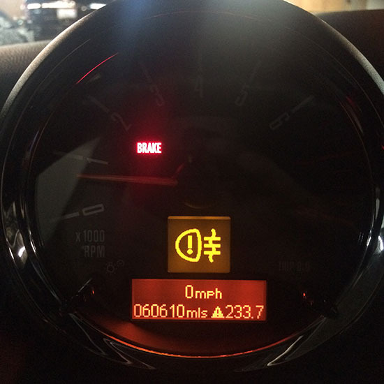

After doing that I have this warning light?
I'd be fine if there was just a way to disable all the bulb checks, but ideally I would be able to only do the ones for the rear fogs.
Any help appreciated.

If you change your vehicle order to delete the rear fog option, then the car will not check because it will think that it doesn't have them.
Delete the $5AA option and default the FRM module.
Otherwise just set the kaltue and warmue with NSL to nicht_aktiv. You will have a right and left unless you have the JCW kit where you will only have to disable the one side.
Thanks cerenkov. Always coming through with the knowledge.

Also, I tried just setting the kaltue and warmue to nicht_aktiv again and that does remove the rear fog bulb warning but then I'm shown the regular bulb warning.
Perhaps I have another bulb out somewhere? Is there a way to check which bulb is triggering that?

Yep looks l have another bulb out... kinda...
Went by a shop doing some other work for me, they had a better fault reader then the DashCmd or PowerGate reader I have access to and sure enough its showing A8AD - "Side marker light, right faulty"
Funny thing is both right side marker lights (in the wheel well) are functioning.
I'm wondering if I'm part of this service bulletin -SIM630110.pdf
That fault code is listed in it.
It says its build months of 8/2009 thru 8/2010 but mine was built in 11/2010... seems close enough.
I read on some other thread it was just a change the dealer had to make to the FRM. Anybody have any idea or clue how to do that myself? I don't want to take it to the dealer and they default all the other changes in my FRM and other files.
