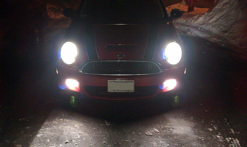

Any chance of a photo, head on of yours at night? (lights on obviously)
I want to eliminate like yours the contrast of White bright headlights and Murky yellow DRL's.
Nice, I'd do white turn signals my self but I think they are illegal in MA and I don't need anymore run-in's with the law
I'll get a picture head on as soon as possible, The weather has kinda turned over here so I'll get one when it clears up.

Onemcs, I decided to grab a shot with my cellphone last night, its not the best but its not a bad representation of what the color is.
