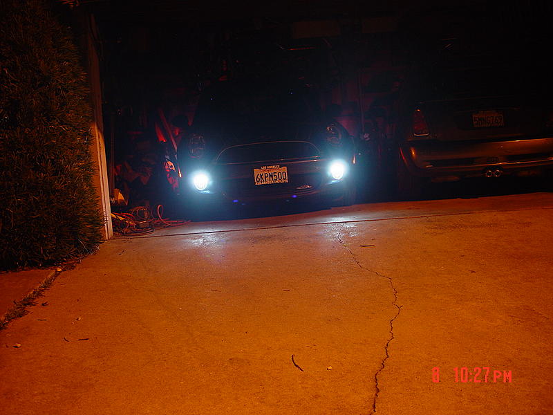

I love those 3 watt parking lights. (I just tried to attach a photo, if it doesn't come through check my gallery). My turn signals haven't made it yet. Shipping is almost 4 weeks from Hong Kong.
13 watt rear fogs would be ungodly bright. I have to see that! I haven't hooked mine up yet because I am dreading pulling the dash apart only for the dealer to charge me $200.00 for reprogramming a $100.00 option. But I am sure I could tap another 13 watts into the front fogs and be done with it.
