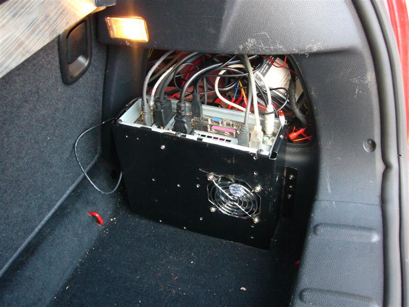

I did similar but put my 7" Lilliput screen where the OE Sat Nav screen used to be, tight squeeeeeeeze though.
Put PC in CD Changer bracket in RHS of boot.

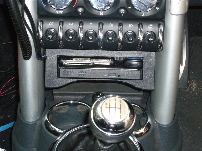

My setup is a 7" Lilliput touchscreen VGA 800x480 LCD squeeeezed into where the 6.5" Sat Nav Screen used to be.
Underneath the Toggle Switch Pack is a 4 port USB hub with USB DVD/CD drive, USB GPS (Garmin Mobile PC), USb Card Reader & USB IR remote.
PC is an NEC Flex ATX SFF Mobo with 60GB 2.5" HDD, M2-ATX PSU, 1GB RAM, AGP VGA card, PCI USB card & PCI Wifi card with Car2PC interface for sound fed to stock HU via CDC input.

Originally Posted by AK.JCW
Is your Mobo in a case or did you make something to put it in? how do you like it's daily operation? what i'm looking for is if the system is a pain to use.
Mobo is mounted to the Desktop PC cutdown backplate which is then screwed to the CD changer bracket.
Daily op is fine, though resume is a little slow and screen shows fingerprints.
Some photos attached......
