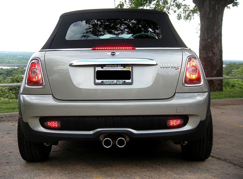

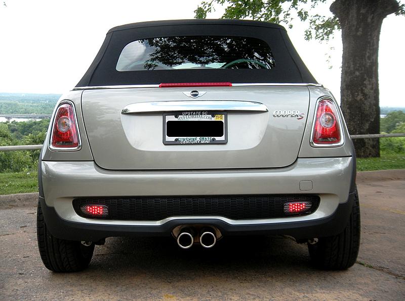

LED Fogs INSTALLED AND LIT!!!!
Sorry to hear they are currently not listed, but they are on from time to time...you can always call http://www.ciraya.com/Info.htm. they shouldnt cost more then $65
Here are mine installed.....the part i wasnt expecting was that when i hooked them up i got Parking and Brake lights!!!!
No Bulb out warning!
This shot is before the LED Tail Lights are installed and the rear Sport Stripes...STAY TUNED!
UPDATE! Here is the link that explains how i installed them:
https://www.northamericanmotoring.co...ake-lites.html
Attached Thumbnails LED Rear Foglights-parking.jpg   LED Rear Foglights-brake.jpg
