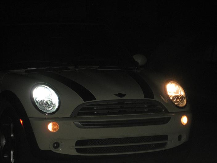

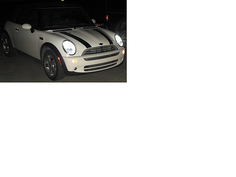

As you can see from the pictures below, the light output is significantly higher with the Xenon in the stock housing. The halogen bulb, as mentioned before, is an H7 65W Osram brand bulb. I installed both HID kits into the driver and passenger light assemblies and took the car for a test drive. The first oncoming car just happened to be a local sheriff. Not a flinch. Continuing on my short journey I both drove behind other cars and approached oncoming cars. Not once did I get flashed. Not once did I observe anyone adjust their rear view mirrors.

Osram 65W H7 (Driver) vs. 6000K Xenon HID H7 (Passenger)
Osram (Left) vs. Xenon (Right)
Full Xenon
