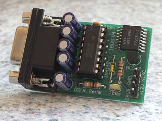

Picture of the IBus interface
From http://www.reslers.de/IBUS/index.html
You could build a RS232 circuit for your Arduino to talk with the IBus module, but I chose to interface the two directly to save having to build another complex circuit.
The RS232 version of the IBus module was easier to hack/work with as the Max232 DIP used on the RS232 version is MUCH larger than the one in the USB version (surface mount chip with VERY small pins).
Cut Pin 9 on the Max232, solder a wire from the circuit board where Pin 9 was soldered to (or it's solder pad on the underside of the board) -> Arduino Rx pin (Read data from the IBus).
Solder a wire to Pin 10 on the Max232 (or it's solder pad on the underside of the board) <- Arduino Tx pin (Send data to the IBus)
Solder a wire to Pin 11 on the Max 232, this stays High while there is data/activity and goes Low when there is no activity on the IBus and when it's safe to inject data into the IBus.
Another US company also offers IBus communications modules: eedesignkits.com
I have however, not been able to get in touch with them to see if they are still offering these items for sale and their designs are surface mount and may be hard to modify/hack into interfacing directly with the Arduino.
Dave
Dave

The old NewMINIStuff module DID read the IBUS... never heard the story about getting two to run the two buttons before... only thing I ever heard was that it was "hardwired" to only read one button / respond to one code. It was an integration module Mikey got from some company that did lots of these things for audio/phone integration for various cars.
I have the newministuff module. It installs on the harness at the back of the radio and works through the iBus. There were two variations -- one that controls a relay (I have this), and one that triggers radio mute.
I have the OEM rear view camera, and I use the module to trigger on-demand viewing (the camera is normally enabled only when reverse gear is engaged). I could have done this with a simple toggle switch, but it's slick to have it on a steering wheel button.
So it sound like they did create 2 versions, one for each specific button. Interesting way to do it I guess.
Their method of hooking up to the stereo head unit harness is cleaner but much more involved. Hooking it up in the Boot at the CD Changer gives you the IBUS data line, Power and Ground all in one place without having to cut/splice or take anything apart.

Well done DaveC, good to see another fanatic on the site
Long long ago, I did a "spin off" of my HKenabler, which provided a single relay contact that followed a steering wheel button status:
I also did a one-off for a friend, that did a similar thing to you, enabling him to control an iPod by hacking in to an off-the-shelf remote (see here for pictures)
The downside of iBus circuits is that they are more tricky for the average MINI owner to install - and an error can risk doing very bad things to the car electrics! But making use of those dead buttons is tempting
Quick review of your circuit ... I'd have used 10K for the transistor base drives, only because then it's the same part on the whole board!
Note that the transistor emitter (your pin 2) must be connected to ground, so there's not much point bringing each pin 2 out - you can't use the transistors as "floating switches".
As for the R56, iBus basically doesn't exist - it's CANbus now, requiring more expensive electronics. I've made no attempt to decode any R56 communications (only owning an R56 for three weeks in the middle of winter, limited development time!)
Finally, if there was enough interest in this, I might be able to produce a circuit that connected to iBus and brought transistor outputs to mimic the switches, for certainly less than the $90 price you needed to pay for your parts - but there would need to be more than a couple of people needing it, to bring the price down. Not that I'm wanting to steal anything, it's just that I've done it before ...

Ian,
Thanks for the feedback. I thought I had given proper attribution to you in my post as the originator of using a PIC to access the IBUS and control an iPod. I have now clarified it in my first post, I saw your initial work (awhile ago on your blog and in the Hack the IBus Yahoo Group) and it was the basis for me trying to do something similar.
Since I don't know much about programming embedded PIC's, the Arduino seemed like a easier for me (and hopefully others) to get started with so I thought I'd try to independently replicated what you did using some noob friendly hardware (ie. program in C, free IDE that runs in Windows, OS X, Linux, programming via a serial->TTL device rather than via a dedicated AVR programmer).
You're right about that. I remember once accidentally flipping the IBUS cable and hooking it up reversed...my AC quit working, my MFSW buttons quit responding until I unplugged it and got it plugged in correctly. Luckily no permanent damage was done, but it sure was a scary moment. You're completely correct that this is NOT a project for total beginners and definitely not for the faint of heart.
I'm re-doing my boards with polarized connectors to make sure this can't happpen again.
That's a great idea for the Resistors, thank you. I guess the actual values aren't that critical for what I'm using it for?
The reason I have pin2 switched via a transistor is that the Arduino has a nasty habit of not booting all the way when first powered up/reset if there is serial data coming in (ie. from the IBUS communications unit) as it is waiting for a new program (they call it a "Sketch") to be uploaded. The IBUS data will not corrupt or overwrite the Arduino's Sketch as it's highly improbable that the data will come in in the right format/protocol, but it will keep the Arduino from finishing it's boot up.
I got around this by using Output 2 (Pin 5, held Low at startup) to switch the IBUS data coming into pin 2 via the transistor (Output goes to High after the Arduino has started up and the program has initialized). It seems to work well this way. Is there a better way to do this? I'm guessing you used a custom programmed AVR or some other PIC and didn't have this issue. It's a trade off for using the Arduino.

Yes, the transistor base resistor values aren't critical - and a lower 10K is better anyway, so long as it doesn't overload the Arduino (which I'm sure it won't - most of these devices can handle as much as an LED load!)
The "pin 2" I was referring to was what you call OUT10/11/12/13 - those transistors have to be grounded, since their base turn-on is referred to that pin.
