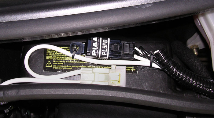

Finally done!
Okay, my PIAA's are in and work well. I took my time, took tips from all who offered, (thanks!) and thought I would post a few photos that may help others down the line.
I mounted the relay and fuse on top of the airbox bump-out with Dual-Lock and that seemed to be the perfect place for running the wires to their needed positions. I shortened all of the light wires and reconnected with some waterproof male/female connectors. I ran the switch wire through the grommet that has the brake line running through it. It was much easier to reach and work with IMHO. All of the wiring was tucked in the area in front of the brake master cylinder with the ground running to the fender mount bolt near the ground strap that runs down the hood hinge. I used a dremel tool to grind away areas on the plastic hood covers (later models) that fit in the slots where the light wires go thorugh, for the brackets and wires. DO NOT try to snip this it will snap like a twig. Use a file or dremel tool and it shapes nicely.
Hope this may give some others some help, and again thanks to all who helped me.
