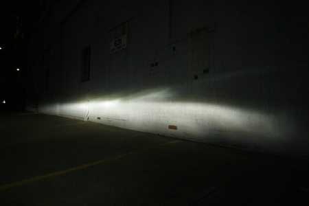

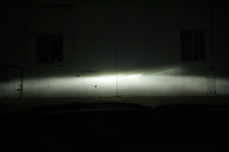

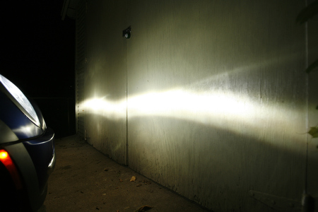

Here's what my 04 xenons look like w/ D2S bulbs when you need D2R. I haven't gotten flashed yet, but I should be... Glare is bad. D2R should be here any day.

Yikes....thats really bad glare. Definitely shows the importance of proper bulb shape/size
