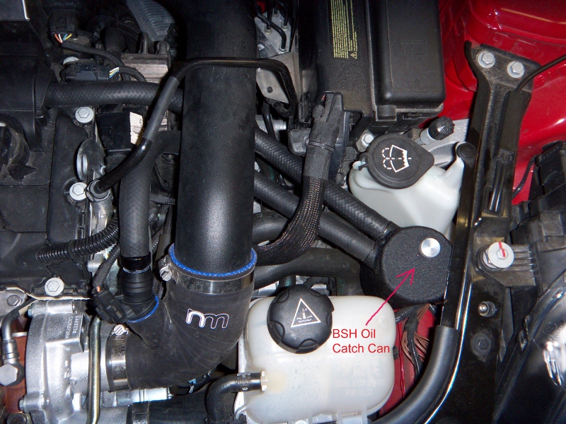

BSH Oil Catch Can
Installed the BSH oil catch can in the MCS tonight. Definitely had some gunk at the end of the PCV tube going into the turbo, and that's at 14,184 on the odometer. Very easy install and the BSH can is well built. When it comes time to drain it, I will probably use a siphon rather than the drain plug. The plug looks like it could be tough to get to easily and could be messy catching the drainage amongst all the hoses.

Wow...that was a fast turnaround. Didn't take you long to get it installed. It looks real good -- like OEM equipment. I've seen several folks using a livestock syringe with a straw on the end or something similar to suck the muck out through the dipstick hole, rather than trying to get to the drain plug. Quite a bit easier, I would think.
As soon as BSH figures out the fitment for the N18 engine configuration on the '11 models, I may not be far behind you.

Jo, here's a basic explanation as to the purpose of an OCC -
http://wiki.answers.com/Q/What_is_an_oil_catch_can
You may have seen in other threads that the R56 turbo engine, like many other direct injection engines, is susceptible to carbon build-up in the intake ports and on the intake valves from the PCV system since the fuel and its additives never have the chance to "wash" over them. An OCC helps reduce the amount of "stuff" in your crankcase vapors getting back to your intake. These don't come factory installed because they need to be drained regularly and that requires too much attentiveness for your average new car buyer.
There's lots of threads here on NAM on the subject, and many of the vendors market different brands of OCCs. The BSH can seems to be one of the favorites.

Gary - Great link and explanation. Makes me feel even better about the install.
