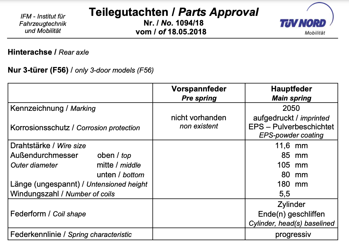

These springs are not from the lowering springs kit. These are the rear springs from the F56 KW v2 comfort coilovers.
If you look at all of the TUV parts approvals for the different coilovers for the F56, you will see that KW and ST share the same springs front and back on the F56. For the comfort coilovers, the only difference are the rear springs. They are only slightly less stiff.
I tried these on my SE and it provided a smoother ride but it was too low for me. I run about a 1" gap between the tire and the wheel arch but you are much lower than my car. That is why I suggested it when you said you were looking for new rear springs.
