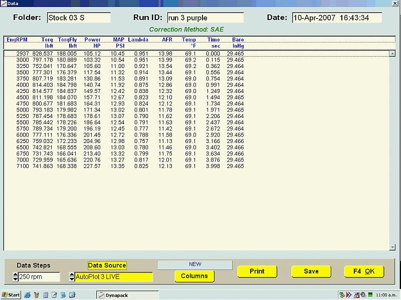

Here is a tune done last week by Lucky Dog. Previous tunes have varied depending on the Dyno. Previously in the same week the car made 194 hp on Helix's Mustang in the same week under similar conditions as it made 237 HP on a Dynojet. After Helix's reconfiguration it made 216 HP, which is a lot for a s/c only mcs on the Helix dyno.
At the start of this tune the car dynoed at 218 hp with the BBR software. Lucky Dog was able to raise the hp a bit but did a great job in raising the torque curve. John is committed to a high level of worksmanship was able fine tune Cosmic Purple.
https://www.northamericanmotoring.co...1&d=1176780187
With the 400cc injectors fuel was not a problem. The limiting factor was clutch slippage. Current clutch is SPEC 3+. John is able to adjust parameters up to 6900 RPM. The dyno here shows 7200 RPM. The rev limiter which was set by BBR is set at 7800. John wasn't really tuning for HP. I'm sure if we revved higher the numbers wouldv'e been higher. After speaking with John i no longer think revving up that high is of that much value because of where the TQ curve is.
This approach may be the missing link to maximizing the M62 project.
Anyway, the car feels really nice and pulls a lot stronger. Peace!

188 or 168
Just wonder, the header says 188for tq and chart says 168tq. Is there a convertion for something I do not know, or just a finger on wrong key?
Impressive numbers!

^^ I don't think you are reading the chart correctly.

188tq @ 2900 rpm.

On the chart why did you chop off the lower RPM at 2900? Is that the start of your RPM range of interest? And is that torque bucket at ~3300 normal? Any idea why it is there? Any idea how to get rid of it? Do you want to get rid of it?
