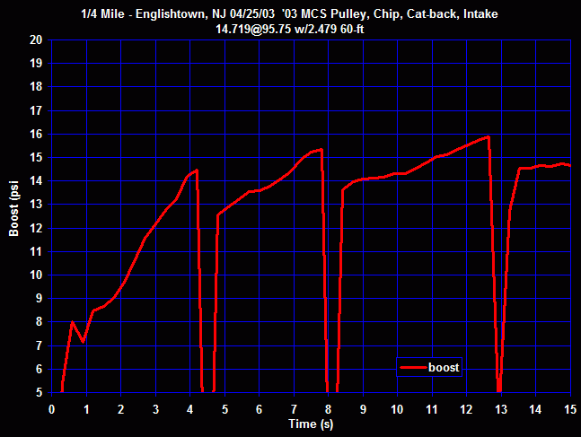

Here's some purdy graphs from my best run:
I forgot to mention my $375 including shipping used wheel/tire combo: 16x6.5" Enkei RPO1 with 205/45-16 Kumho 712
The MTH chip seems to work as well as other solutions so far, but doesn't yield much power. No need to even look at the ECU, just plug in a cable between your PC and diagnostic port in the car:
http://www.mth-powerchip.de/
BTW, my 60-ft time was pretty poor and can certainly be improved upon. I'd hope that professional testers could routinely cut 2.3s or better.
My race weight was 2820 lb with me in it (2612 without me).

What happened at 90mph?? Did you hit the brakes or something?
Old Apr 26, 2003 | 09:59 PM
andy@ross-tech.com's Avatar
andy@ross-tech.com
Joined: Oct 2002
Posts: 3,652
From: Lansdale, PA
Just a sloppy shift. ops:

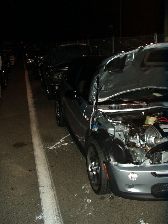

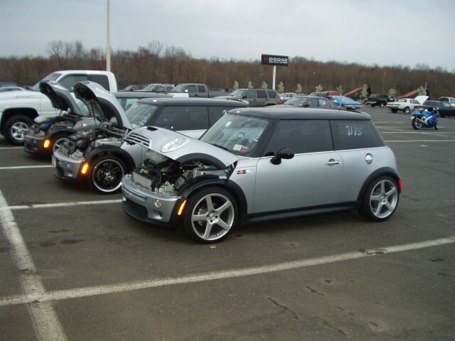

Here's some pics from last Friday. FEAR the MINI's!
minime s has the Kahn 18"s, 1fastmcs has the other PS/B cra, and I have the DS/DS.
