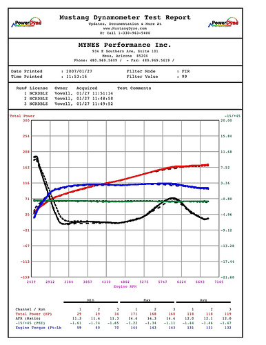

Here's my results from the Mynes/FBR dyno day in Mesa, AZ today...SAE corrected whp(red): 179; torque(blue): 145; 7000 rpm; AFR (black): minimum: 10.8, max: 14.9
Mods are below in sig.
