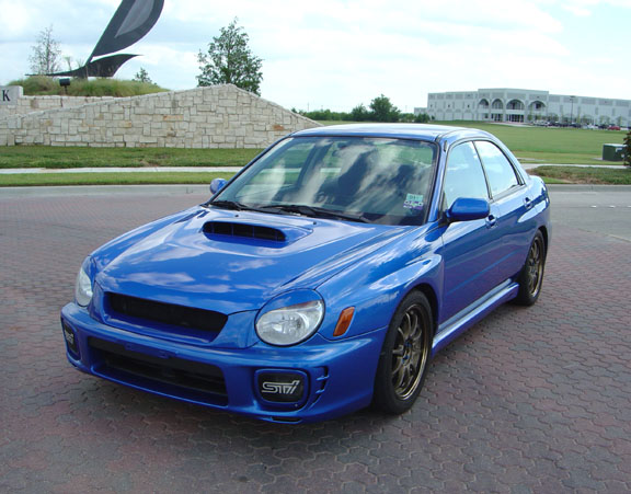

Here is some pictures of my WRX and a List of Mods:
COBB AccessPort - running stage2 93oct
Zerosports Intake pipe, Radiator Shroud
HKS Circle Earth Grounding System
STI short shifter (5 speed)
PDE Downpipe
Tanabe Super Medalion Catback Exhaust with Kartboy Hangers
GReddy Airinx Intake, Oil Cap, Radiator Caps
Power-Lock Security Starter Kill System
Tein Flex Coilovers
Tein EDFC Controller
Cusco Front/Rear Strut Tower Bars
Volk Racing Lugnuts (Black) and set of (Blue)
Volk CE28N 17x7.5 Bronze
Michelin Pilot Sport PS2 225/45 17
STI Hood Scoop, Mesh Foglight Covers, Shifter Trim
Liberal Headlight Eyelines, Style Grill
Perrin Shift ****
Whitline Camber Bolts
Defi Dash Pod
Defi Link System 60mm Gauges - Boost, EGT, Oil Press, Control Unit V2
Crucial Racing Thermostat
COBB Up-pipe
COBB Main Pulley
Prodrive Battery Tie-Down
JMB Oil Catch Can
Samco Intercooler Hose Kit
STI Engine Mounts
Goodridge Brake Hose, Stainless Braided Clutch Hose
Stoptech Rotors
Hawk HPS Pads
ACT Pro - Street Clutch
GFB Hybrid BOV
Kartboy Shifter Bushings, Rear Shifter Bushing, Exchast Hangers
Whiteline Steering Rack Bushings, Rear Differential Bushings
