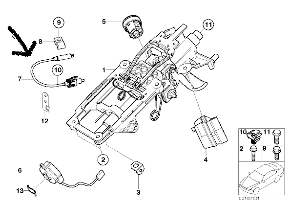

Old Sep 28, 2008 | 01:09 AM
UKSUV's Avatar
UKSUV
Joined: Oct 2004
Posts: 3,673
From: Marsala, Sicily
Originally Posted by Wolfe_13
changed on other cars before, but I need to know where they are on this one
Here....let me do your homework for you free of charge.
WHEEL SPEED SENSOR:
STEERING ANGLE SENSOR:
Old Sep 28, 2008 | 01:17 AM
UKSUV's Avatar
UKSUV
Joined: Oct 2004
Posts: 3,673
Ok, so either steering wheel/angle sensor or a wheel speed sensor.
I cleared the codes and ran the car for a while without driving and they haven't come back on. So I would like to disconnect them one at a time tomorrow to see if the lights come back on, and then I know what to fix. I don't have a manual yet so can someone tell me where they are? Maybe add some pictures?
Try http://www.realoem.com . Thats where most of us get the info. The system is closed loop. If you disconnect a part it will trigger a code. And the code is generic for the system...You can still drive the car with the lights on...BUT BE EXTREMELY CAREFUL. Your ABS will NOT work and brake feel is very different. I had these lights come on about 5 years ago and the dealer replaced the SAS. And then about 3 months ago had them again. Every time I would make a hard left...the lights would pop on. Not caring (since I had 9 dash lights on) I drove the car. After about a week...the lights permanently went out. You need to clear the malfunction and drive it 3 start and drive cycles to clear the code.
WHEEL SPEED SENSOR:
Item 6 is the Steering Sensor; not item 7.
Old Sep 28, 2008 | 01:55 AM
UKSUV's Avatar
UKSUV
Joined: Oct 2004
Posts: 3,673
Oh yea....sorry...I was doing it real quick....some of us dont live on here...It is indeed NUMBER 6
