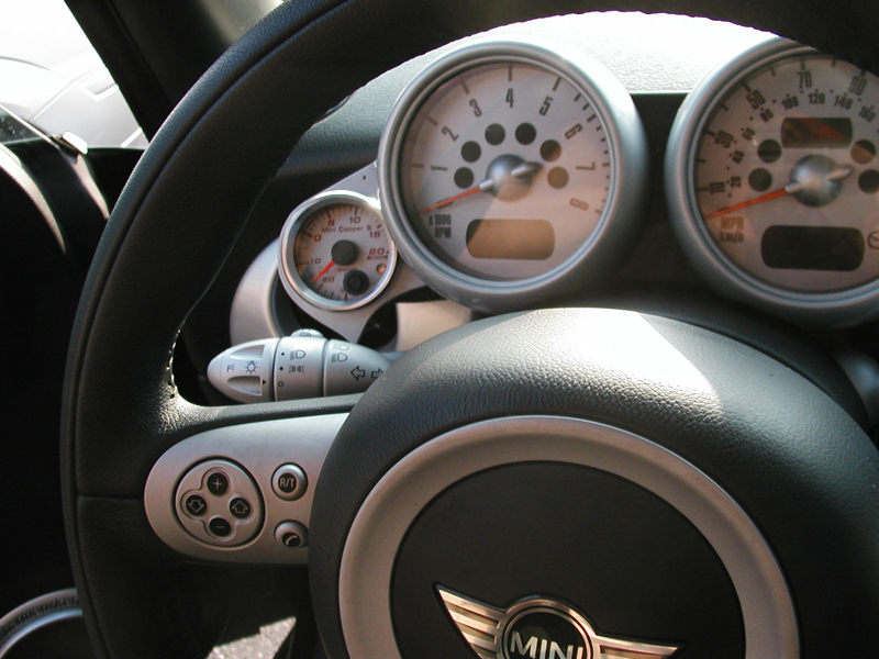

no fuel lines in the cab, under the hood. Once I get my data logging equipment then I'll have fuel pressure in the cab. -- I tried to get a picture from behind the gauge cluster but it didn't turn out very well. I'll try again later. All I did was take out two of the four screws that hold the stock gauges together and get longer ones to attach my bracket. So it just mounts flush. (with a little rubber gasket to prevent any chaffing) You'll notice too that the gauges are angled in a couple of degrees to make it easier to see. -- Johan

There's no such thigs as a stupid questions...the boost gauge was simple to install. The kit that I got from www.speedhut.com came with almost everything I needed. All I had to get was some small vacume hose and a "t" connection. Then "T" off of the bottom of the fuel regulatar and into the sensor for the gauge. Anyone who's done the VGS know's what I mean and if you were wanting to do the VGS now is a great time to do so!(https://www.northamericanmotoring.co...on+vacuum+gain) Run some basic wires and that's pretty much it! Oh it does come with instructions with pictures too!! Hope that helps -- Johan

Thanks for the compliments! I enjoy fabricating metals. Keep in mind, there's not room for a deep gauge on the passenger side. (Well maybe if I put a larger off-set) That's why I went with the Speedhut gauges. There only 1" deep, plus there fully electronic and you don't need a special module or box to run the gauges. There more expensive though. Let me take a look and do some more figuring. I'll keep you guys posted! -- Johan
