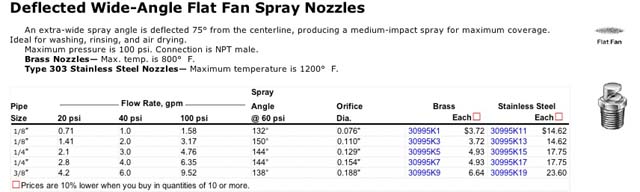

Here's a screen shot of the info

Has anyone used these types of nozzles "deflected flat fan"? what is the flow on these nozzles? Are they a fine mist or more of a spray type? That is exactly what i am looking for in design. I need an angled fogger type nozzle to allow me to mount it on the lip of the inside hood scoop before the intercooler.
