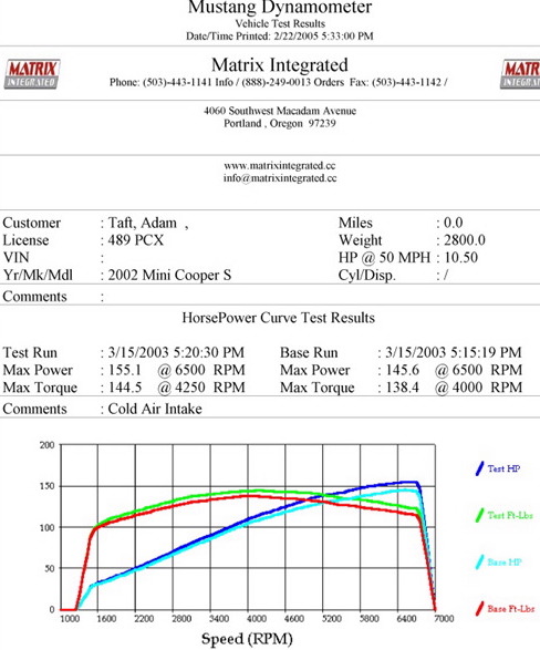

Seems funny, our intake by itself, no ECU is a 10WHP gain. The unichip is supposed to give you about 5HP more than other chips, so somewhere in the 10WHP range. Even 10 is very noticable, 20 is very noticalbe. Where do you live and what kind of gas do you have there?
would you please post the dyno runs showing a 10 hp gain from your intake. please also indicate whether the tests were run with the hood open or the hood closed.

We always do it with the hood open, and fan on IC. This keeps it consistant from run to run. Hood closed on 90% of cars is not a good idea.
This is our run we did long long ago. Completely stock car, engine wise.
it isn't a fair test to compare the stock inlet with all of its enclosure in place (which doesn't change when the hood is open) to yours with the top of your airbox completely removed by having the hood open. you have lessened the real in-use flow losses to yours by having the hood open.
test them both with the hood closed and see if you get the same result.

flyboy2160,
The stock air box gets air from the front of the car, and from the really small hole at the back. With the hood open and with the hood closed is is the same, and maybe better open because the front scoop is much more open. I say more open because the grill acually blocks quite a bit of the scoop (fron direct air)when it is closed.
Our intake gets air from the front of the car and the huge gapping hole from the missing air box wall. Since both these holes are so huge there shouldn't be any difference with the hood open or closed. With the hood closed, the air from the front and the air from the window scoop are plenty big enough to not cause any restriction. From a Cool air stand point, the air it gets on the dyno with the hood open or closed is going to be the same. The stock box will be sucking most of its air from the front scoop (which is nice cool air) and ours will be getting most of its from the window (nice cool air also.
From this we can deduct hood open and hood closed doesn't really effect the HP. With the hood open though we can place a fan on the IC itself to keep the air flow more consistant. Generally the fans dyno shops use are not powerful enought to simulate 30+MPH winds so having the hood closed and using these fans to cool the IC isn't enough. It is enough to keep the coolant in check, just not the IC.
uea minis idea about the cover would prove the hood down or up is better, but with large window opening it really shouln't make much difference.

"The stock air box gets air from the front of the car....
Our intake gets air from the front of the car and the huge gapping hole from the missing air box wall. Since both these holes are so huge there shouldn't be any difference with the hood open or closed...."
your website shows that you use the same stock front opening, so this front hole isn't "huge" compared to stock, it's the same!!! the rear "hole" is huge compared to stock, but with the hood closed the path is much more open than with it closed.
"From this we can deduct hood open and hood closed doesn't really effect the HP."
i disagree as i disagreed with the recent forge ic test with the hood open. their ic blocks most of the ic slot, but it tested "good" with the hood open.
"This is a good idea, but the Intake is still breathing through a small filter. Even if you install a foam filter, the surface area is pretty small compared to the cone filters on our intakes. I am sure this gains some HP just because the intake gets to breathe through a much larger opening compared to the front scoop but how much, that i would like to see."
the previously reported pressure drops across the stock filter of ~.1 psi indicate that there isn't much to be gained in terms of pressure by changing the filter. about 2 years ago, a poster on mini2 REMOVED THE STOCK mcs filter completely. as i recall, he noted a 1-2 hp gain, which jives nicely with the small pressure drops across the filter. (and is probably well within the margin for error of any dyno test.)
the 10-12 hp improvement claims just don't jive with other data.
