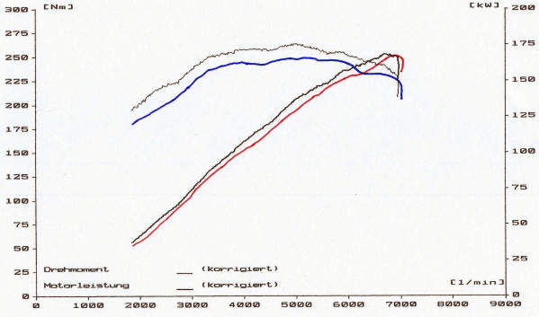

Old Jun 1, 2005 | 11:33 AM
minispilot's Avatar
minispilot
Joined: Jul 2004
Posts: 140
From: SF Bay area
OH NO, it's METRIC!!!!!!!!!!!
To convert metric units:
1 kW = 1,341 HP ; 1,3557 Nm = 1 lb ft
2003 MCS, 56,5mm pully, mth ecu, beru spakplugs, k+n CAI and remus exhaust.
https://www.northamericanmotoring.co...achmentid=3492

Old Jun 1, 2005 | 12:10 PM
andy@ross-tech.com's Avatar
andy@ross-tech.com
Joined: Oct 2002
Posts: 3,652
From: Lansdale, PA
Originally Posted by minispilot
I never said the HAI gave any gains. Im pretty sure the M7 AGS with give 10hp over a stock setup.
I don't really want to do this AGAIN but I will. Where's that damn search button.....
I'm still not following you. You said:
one-ball and header = 10hp/15#tq
pulley = 15hp/10#tq
Crank pulley = ???
ecu = 5hp/5#tq
plugs = ???
HAI = ???
Total = 45 hp
Are all 3 of the blank items responsible for the extra 10 hp?
Then you said:
AGS = 10hp/10#tq
GRS IC = 10hp/10#tq
Injectors = ???
Total 25 hp
Then you added both together to get 70 hp. I don't see how the dyno you posted relates to either the 45 hp or the 70 hp gains you listed.
