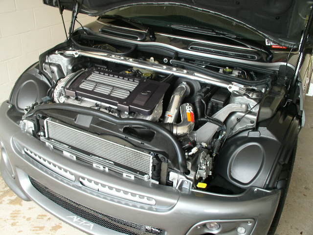

Here's the line:

Location of the tap shouldn't matter much. Mine is routed like this:
As far as cleanliness (or lack thereof) of the engine, that pic was taken in Feb. '03 when the car was 3 months old and had 1500 miles on it. It's much, much, dirtier than that now.
