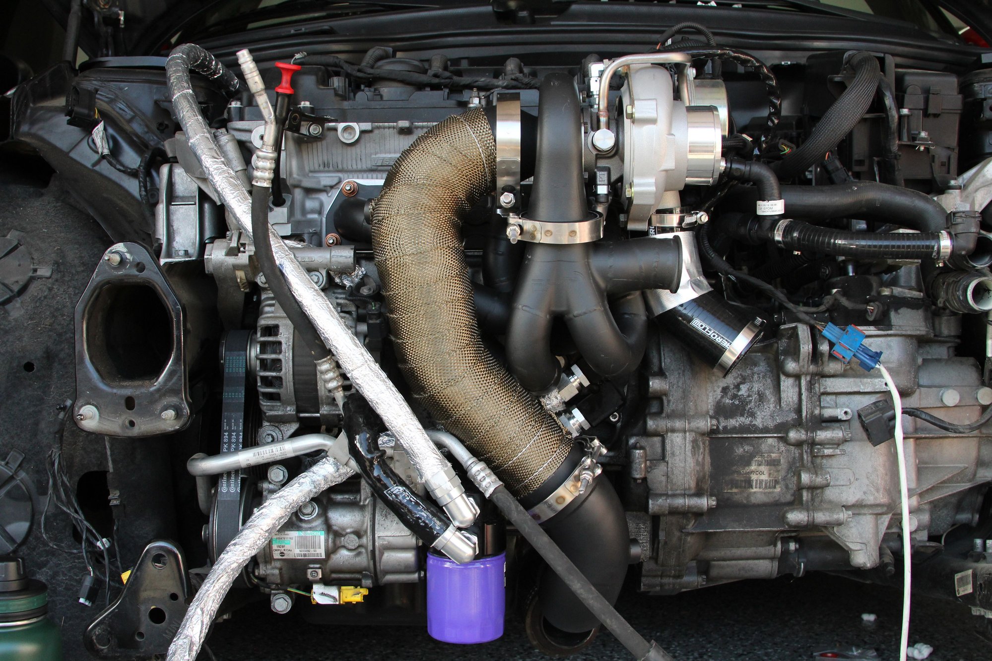

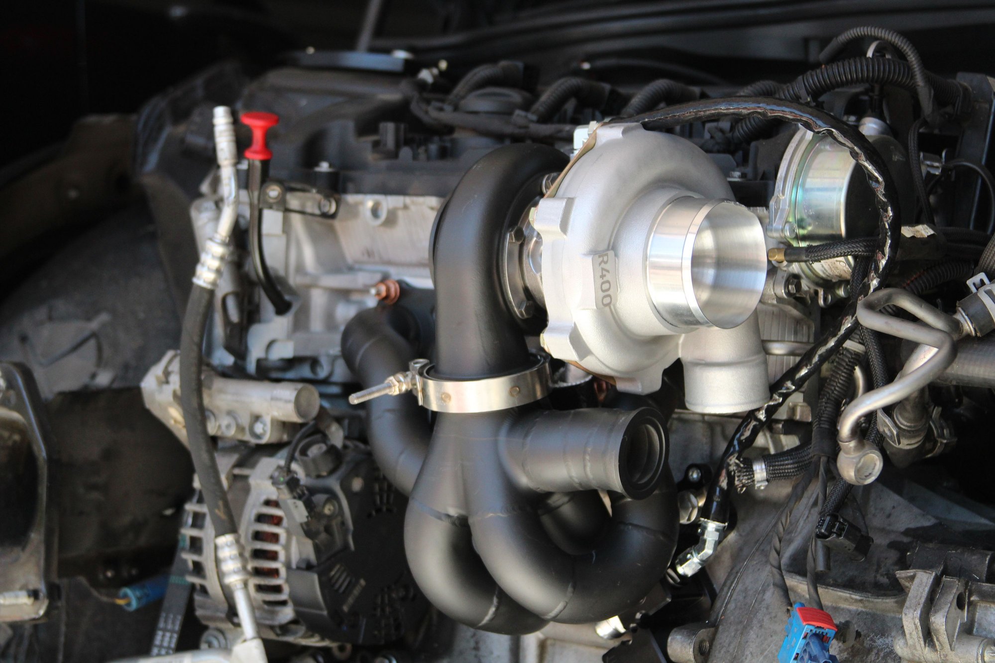

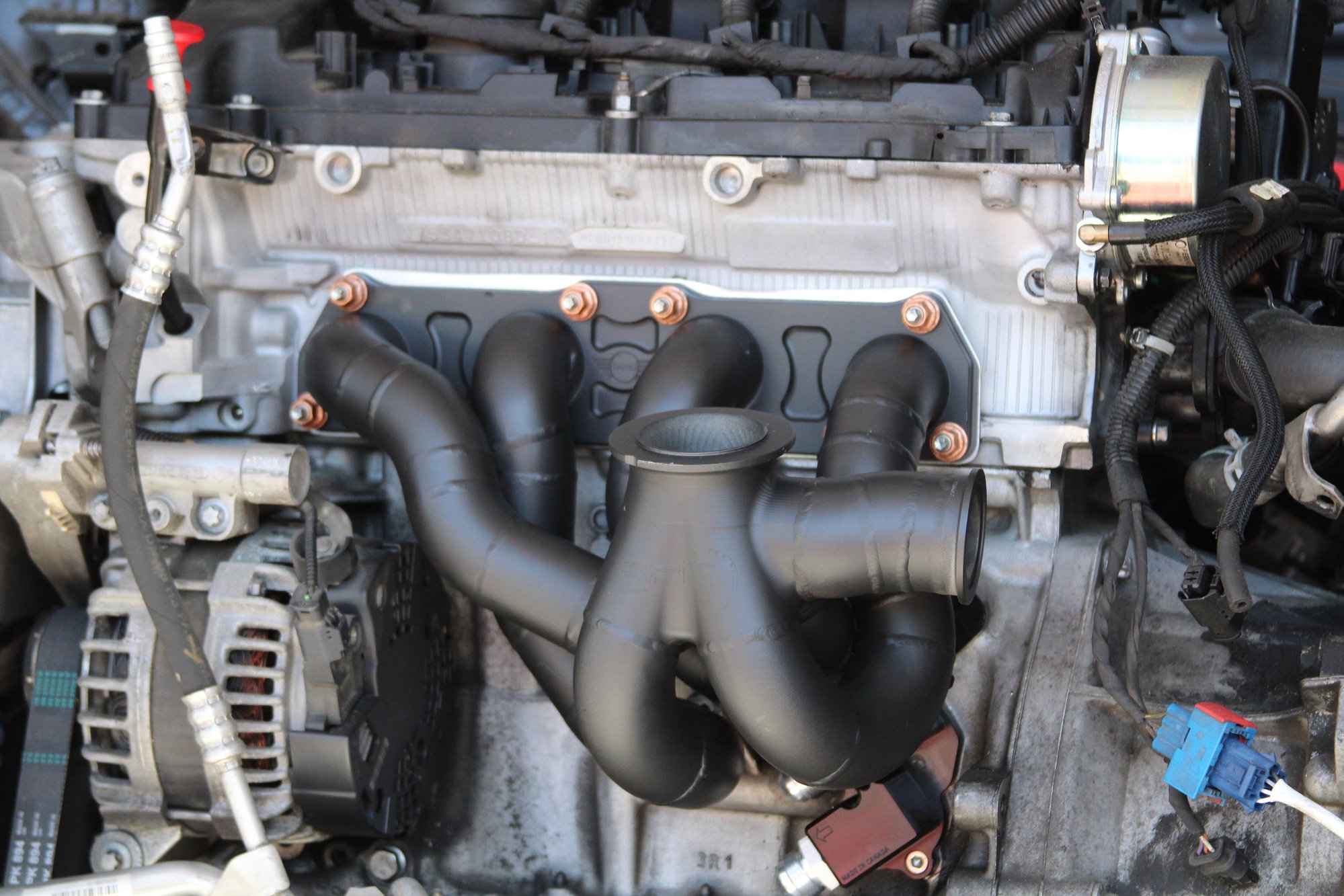

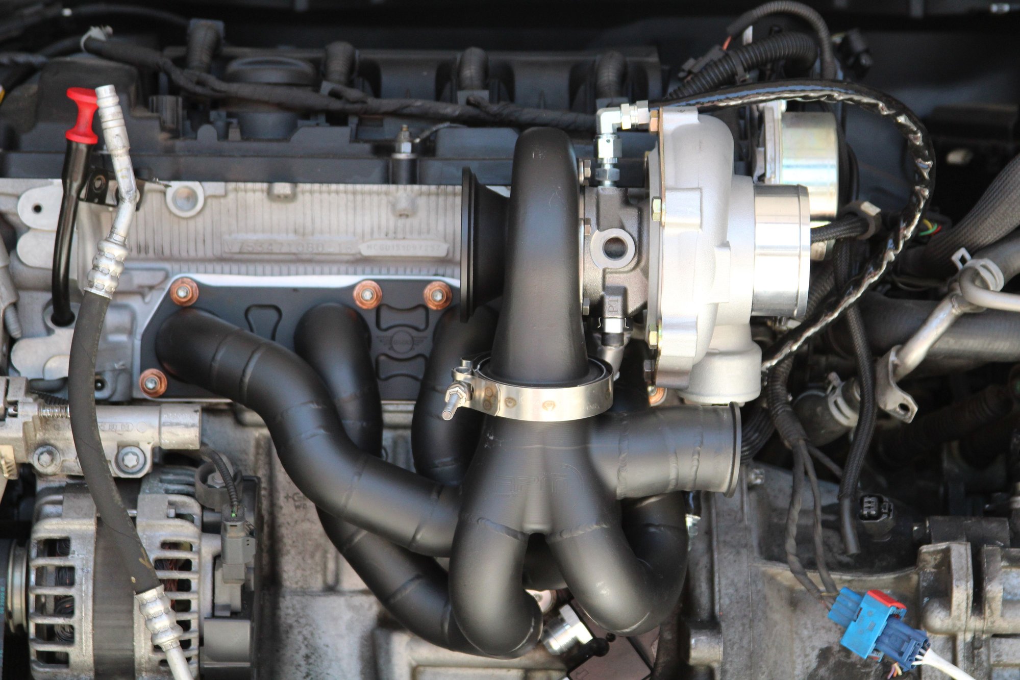

Are you sure you are making 22-23lbs boost untuned? It will go into boost cut and limp mode, you must at least have some sort of base tune
I have an external wastegate on my R400TS turbo kit and the other R400 turbo kits I’ve had. Those turbos and manifolds are designed for the external wastegate, turbos like yours would need a lot of custom work to make an external wastegate work, and there isn’t really a point to it to be honest. I have people ask me this all the time, and I basically tell them you need to buy a 4k turbo kit to run an external wastegate
