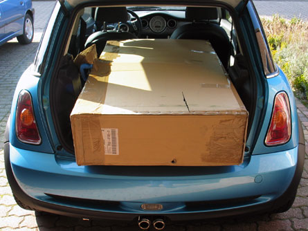

So, will a packaged exhaust system fit in the back of an MCS? I have to get it home from the post office!
Check this link out! Your question will be answered! Cheers!

I am going to have to assume that is a yes. Blocked link (work).

I don't want you to feel left out! Allow me to help!
