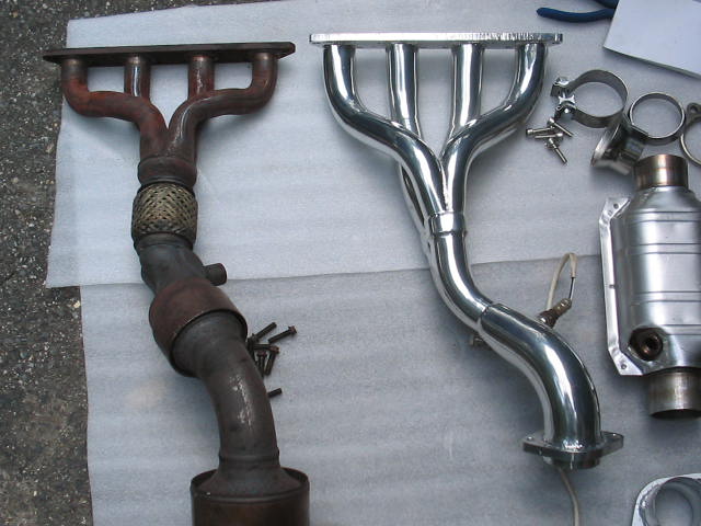

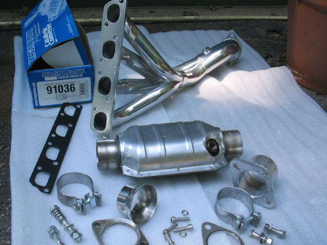

Top Heat shield
Originally Posted by Bahamabart
I have an 03 and I was able to reinstall all of the heat shield once the header was installed.
I made clearances on mine with a 32mm deep well socket over a wood block at cylinder’s #1 & 4. No one can tell there are any change to it. It's easier to remove the coil pack and be good with puzzles to get it back on. The flanged slip on isn’t the one I ended up using at the CAT exit pipe. I had another made-up that was 2.5”id all the way through so it would slip over the CAT exit pipe. There wasn’t any room for a band clamp so I spot welded it a couple of places so I can grind them off and reuse it if I ever have to replace the CAT. The CAT pipe on the header end was expanded to slip fit the OBX supplied socket inside the pipe where I used a band clamp.
All parts are Stainless Steel except some washers I stacked on either side of the springs.
Here are the parts laid out.
Attached Thumbnails OBX-Racing Header Dyno Results!-obx-header-ready-parts1.jpg   OBX-Racing Header Dyno Results!-obx-header-oem-side-by-side.jpg   OBX-Racing Header Dyno Results!-obx-header-ready0005.jpg

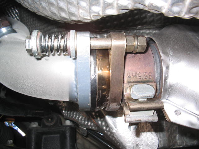

OBX header, CAT connections
Proper spring tension in front and slip on rear connection = leak free & flexible.
Attached Thumbnails OBX-Racing Header Dyno Results!-mcs-cat-front.jpg   OBX-Racing Header Dyno Results!-mcs-cat-rear.jpg

I want to make a system with the OBX that has a bolt in "test pipe" and a bolt in STOCK cat.
If I get the OBX it will come with 1 ball flange and 1 bolt flange
This will work for one of my options,
but I still need 1 more BALL FLANGE and use the BOLT FLANGE on the stock cat
Am I correct ? and where can I get my needed parts ?
Thanks for any info.

You may have to use your own resources here
Originally Posted by COR BLMY
Thanks for all the info folks.
You may have to have it made up. There is an attachment die available for most hydraulic pipe bending machines to form ball socket connections. Any well-equipped exhaust shop should have one. A buddy of mine who has a small shop has one. You would have to have your OBX ball socket on hand to model after.
You could try to get one from an OBX vendor but I don’t think anyone has been able to acquire even a replacement gasket.

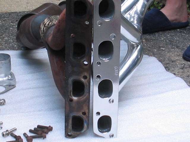

Old Jul 15, 2007 | 09:28 AM
  #538
vodka's Avatar
vodka
Joined: Oct 2006
Posts: 239
Hi all,
I'm interested in the OBX header for my 2004 MINI ONE CVT but I have some question hope all the OBX expert/owner can help me out
1. My engine already has a plastic cover (refer to photo) which covered the OEM header. Aft I install the OBX header, that plastic cover can use back?
2. Does that plastic cover sufficient to reduce heat? Or coating + plastic cover?
3. If I use a flex bellow (sorry, not sure the name is correct or not but you can refer the photo ) to join/weld in between the OBX header and OEM Cat (ie: OBX header -- weld --> flex bellow -- weld --> OEM Cat) will it be better than using the OBX supplied dougnut gaskets, etc ??
4. If I do that, I dont have to use the spring screw, etc?
Thanks a million.
Old Jul 15, 2007 | 09:39 AM
  #539
Dr Obnxs's Avatar
Dr Obnxs
iTrader: (7)
Joined: Sep 2004
Posts: 10,340
From: Woodside, CA
Originally Posted by vodka
Hi all,
Thanks a million.
1) Don't know. On my MCS, I did have to bend the heat shields a bit, so it's possible that you may have to trim or get more drastic with the cover.
2) I was getting more heat with the OBX, but the heat shields on the S are metal, so it wasn't an issue.
3) I don't know if it will be better, but it would eliminate the gasket. Many have run the gasket for many, many miles (me amoung them) with little or no issue. I finally lost one when I lost the nuts (I hadn't double nutted when I first put it in). But that took about 3 year!
4) Correct. All that would go away. You also may find that because of the length of the flex joint, you have to cut the header a bit to make it the same overall lenght as the stocker.
Matt
