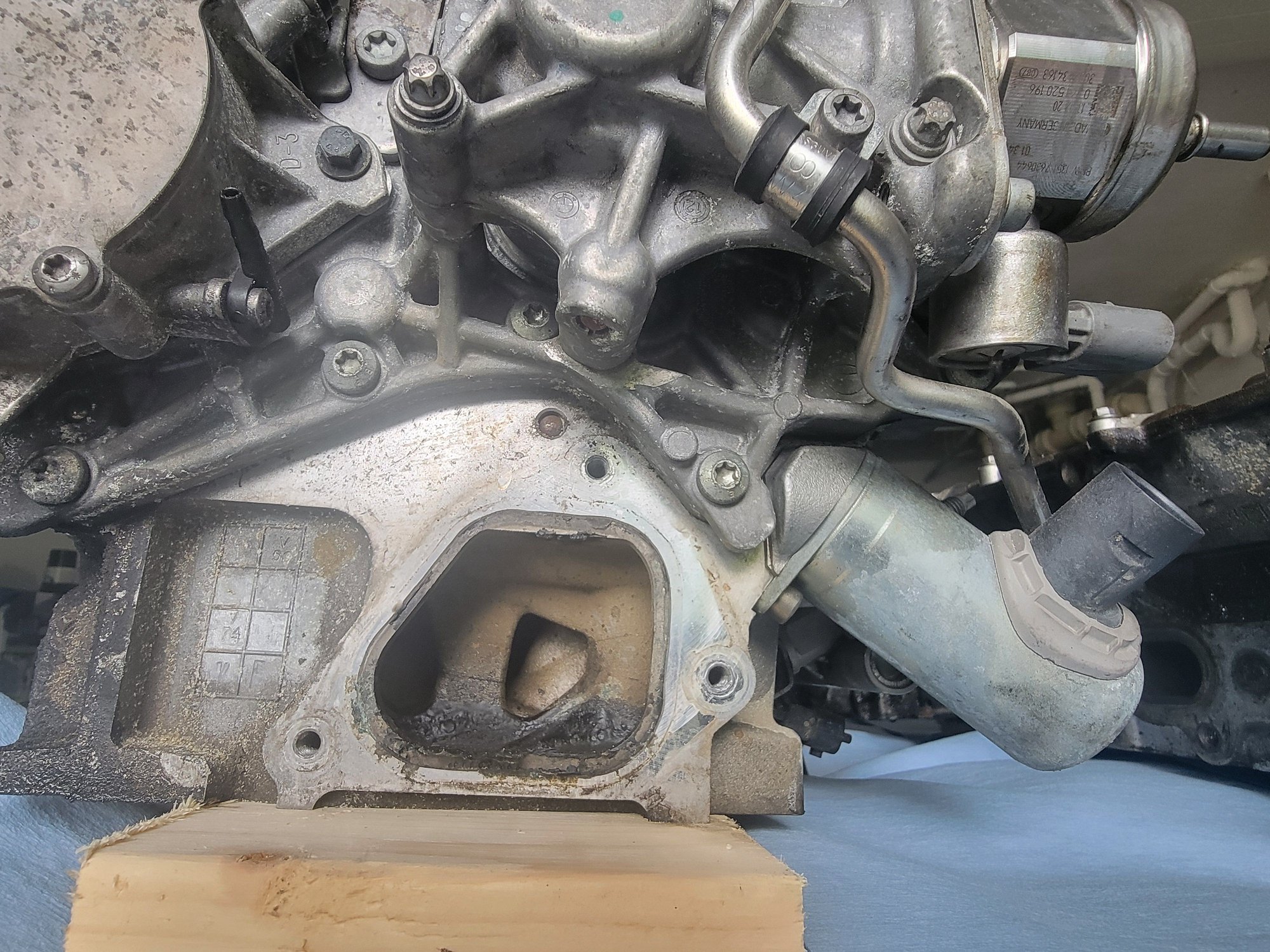

As far as the head and hpfp goes... it is possible to swap the hpfp hardware, however you have to use whichever style the car originally had!
For example my car has the new style hpfp (2013 R60)for the n18 (car over heated catastrophically) and I had a fresh rebuilt n18 head (2012 R56) with the old style hpfp. I was able to swap the intake cam, hpfp and mounting plate, high pressure line to fuel rail, and fuel rail from the 2013 head to the 2012 head with no issues! Car runs and drives with no codes!
N= new style hpfp
O= old style
New style on left, old style on the right
New style has an oil galley in the hole circled that goes all the way through the plate
Old style looks like it has a hole there but it closed off on the back side of the mounting plate
Oil galley in head with new style, also note the keyway at the end of intake came is different from old style which is why you have to change the cam over
Oil galley is present on head but is blocked by the plate, also note the keyway at the end of intake came is different from new style which is why you have to change the cam over
Oil galley opening blocked on back side of plate on old style
Oil galley opening on back side of plate on new style
Fuel line size differences on the fuel rail side which is why you have to swap the rail
All new style parts on old style head
