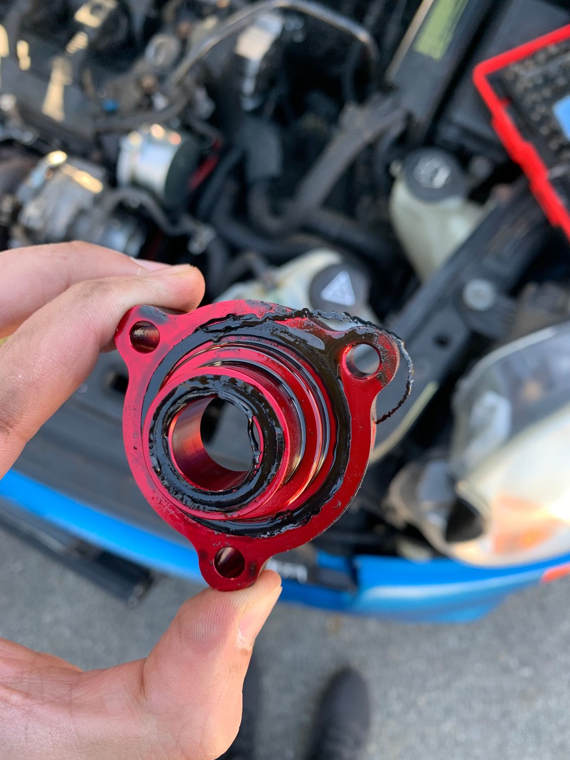

What issues did you have with the cheap Amazon spacer?
As you can see here the o-ring is toast. Had it on the car a little under a year

Yuck! Looks like someone used silicone sealer on it? Or was it just a really cheap o-ring not suitable for higher heat applications?
I would be temped to get a better set of o-rings, clean it up, and try it again.
