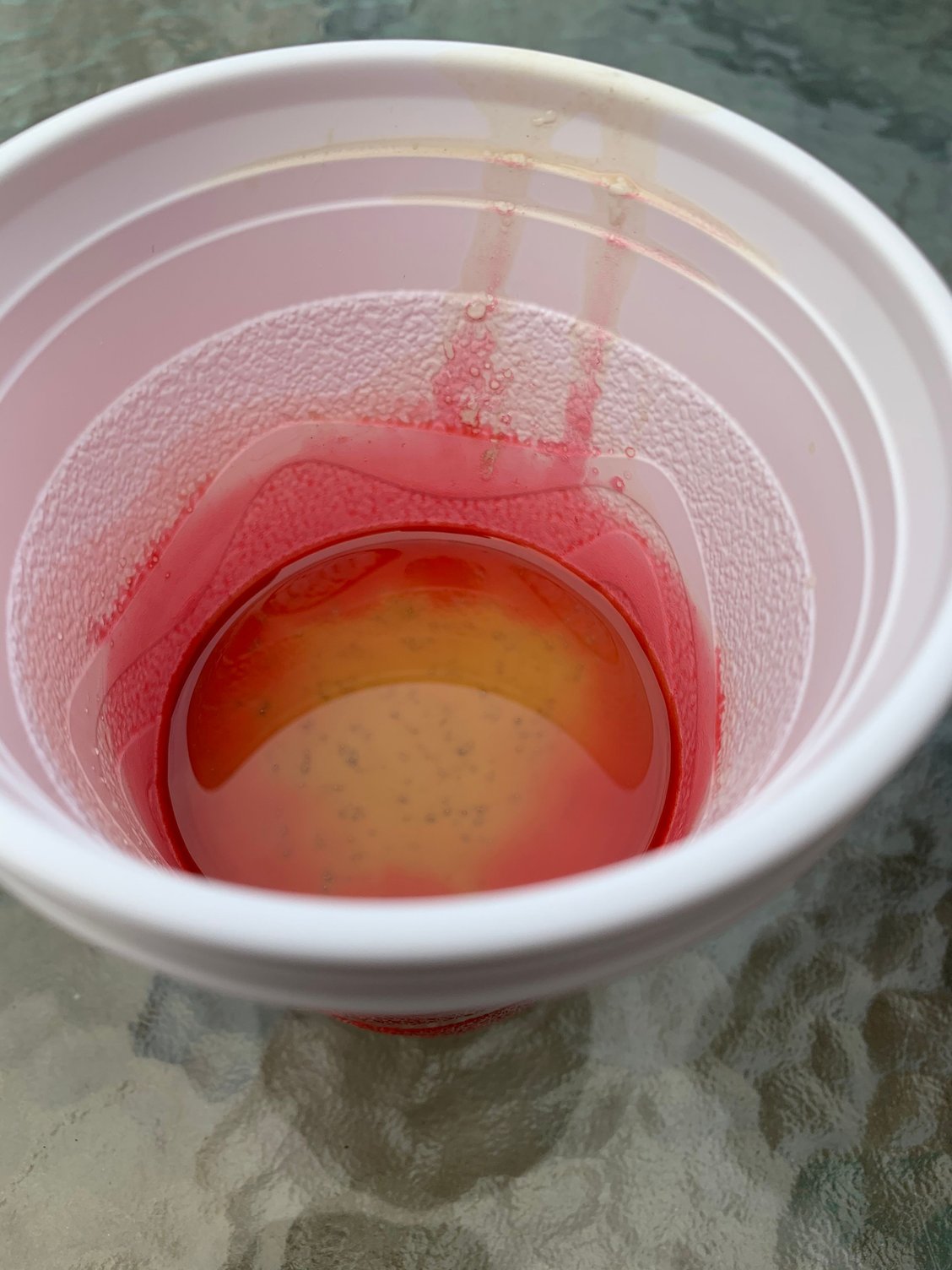

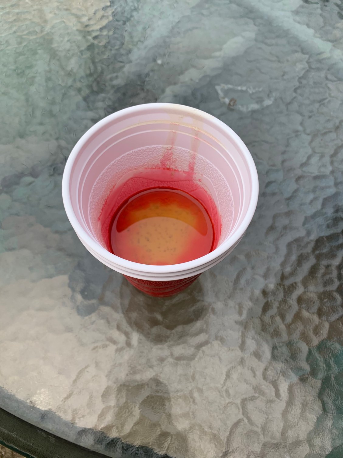

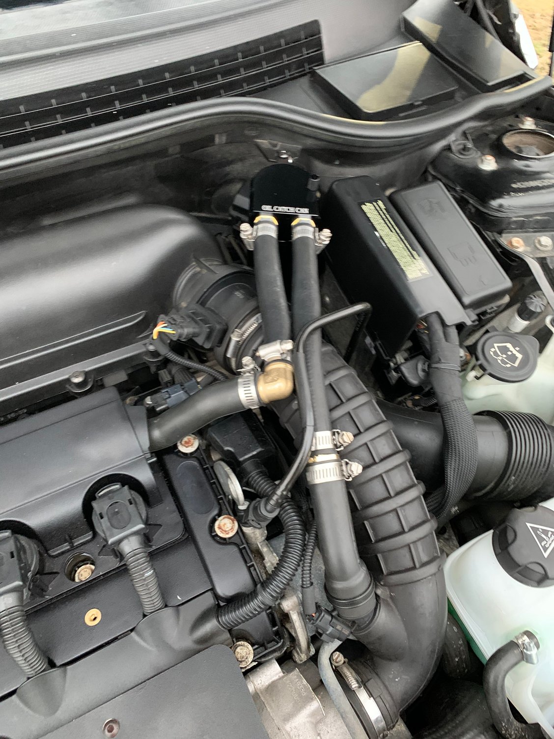

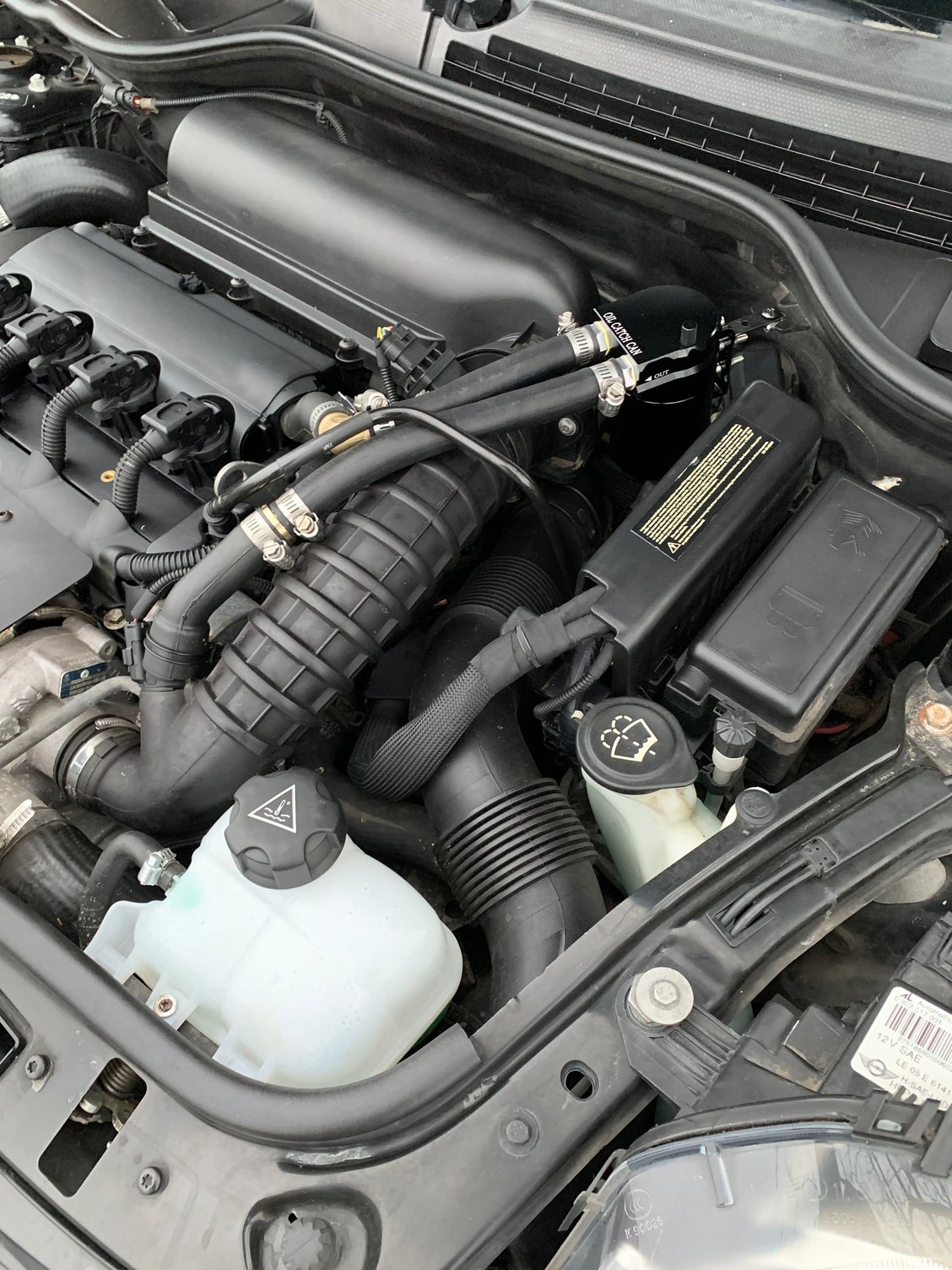

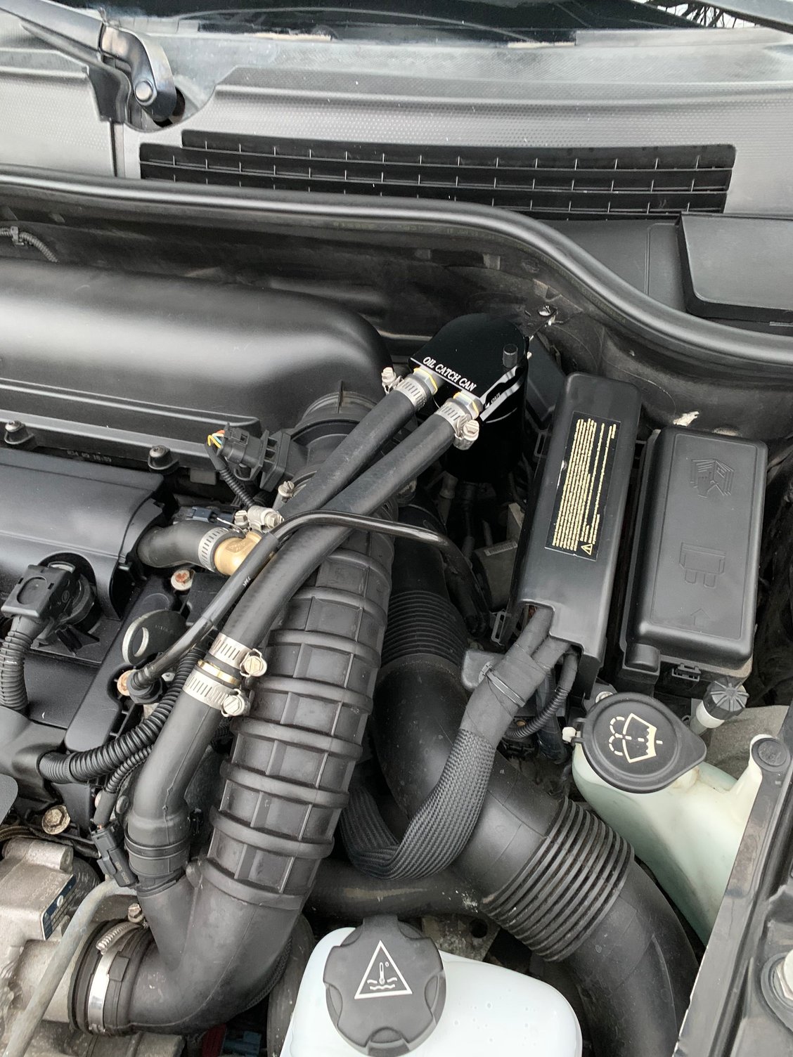

my 09 clubby s
DIY OCC for under 50 bucks. DONT empty into solo cup, that’s why it red, gas eating cup. First empty after 2000 miles. Recommend check way more than that. I’m going to do it every fill up since I’m checking oil anyway. 140,000 on odu
