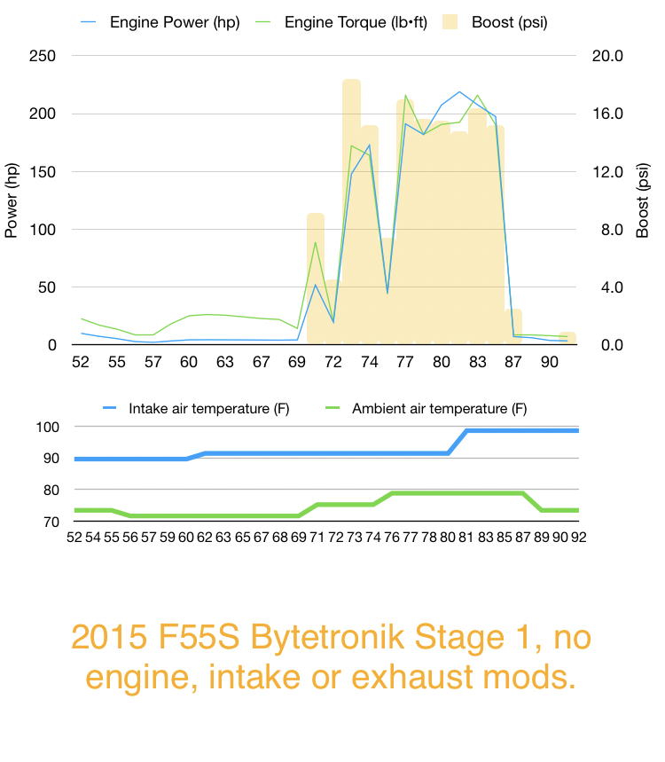

Here’s a datapoint. This data is from last summer; I’ve had zero problems. The original map Bytetronik sent prompted the engine to boost waaaaay too high; they updated it to stay in a safer zone. Usually I don’t see any higher than 16. Below you can see a max of 18psi boost. Ambient and intake air temperatures are also charted.
(JJ and I have also chatted privately about this in the past, but I figure it is good general info to share.)
Horizontal axis is time (seconds elapsed from start of data log) not speed.
Anyway, no powertrain mods of any sort except the tune. It’s a little twitchy in sport mode, with a little bit of surge, but in normal mode it acts, well, normal. If normal is over 200hp, at least. :-)
