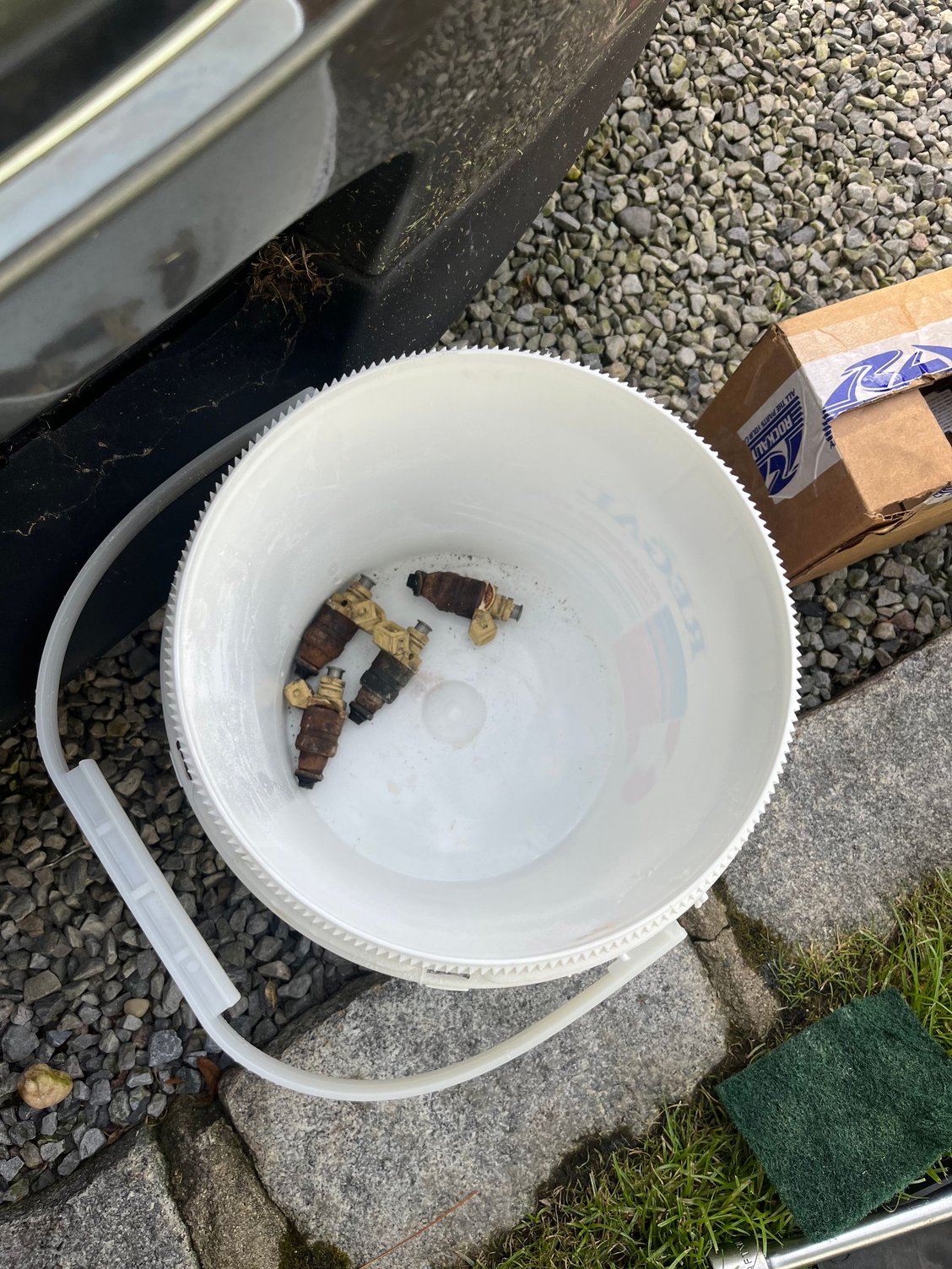

I just replaced my leaky injectors on my 05 MCS. They were the original OEM 330cc injectors. They leaked when the car was off and the idle at cold was a little rough. Thanks for all the great information on this post. I was going to change the connectors and then I came across the last couple of posts talking about the Bosch injectors with using the original connectors.
I ordered the Bosch 62431 386cc injectors. The manufacturing numbers are: 62431 and 0280156063. The SKU number is BOS-0280156063. The Audi OE number is 06A906031BC. These numbers are all the same injector. These injectors cross reference with the 2003-06 Audi TT 1.8L. I ended up getting them from Rockauto.com because they were in stock and I could express them next day. They were $43 per injector. I needed the mini back up so I jumped on those.
The whole installation went very well and the seals worked just fine. The car starts much better now and I have no issues. Very happy with these injectors.
Old 330cc injectors and the new Bosch 386cc injector.
All lubed up and ready to install.
Installed.

Did any of you really struggle to get your original injectors off? What a pain.
Old May 14, 2023 | 10:19 AM
  #72
ghostwrench's Avatar
ghostwrench
Joined: Aug 2019
Posts: 453
Likes: 248
From: Phoenix, AZ
Yes, removing the fuel rail and injectors can be a hassle. That's fairly normal. I've used pry tools before to help but must be very careful to not damage it.
Old May 14, 2023 | 11:38 AM
  #73
daviday's Avatar
daviday
Joined: Feb 2014
Posts: 180
The rail itself was relatively straightforward, for me at least. It was the injectors themselves that gave me the most trouble. I remember getting them off and wondering if I damaged the manifold. I suppose at 160k miles, I shouldn't expect anything to come off easily. At any rate, looked back and paid $131 shipped for 4x 380cc Bosch/Audi Injectors from Rock Auto.
