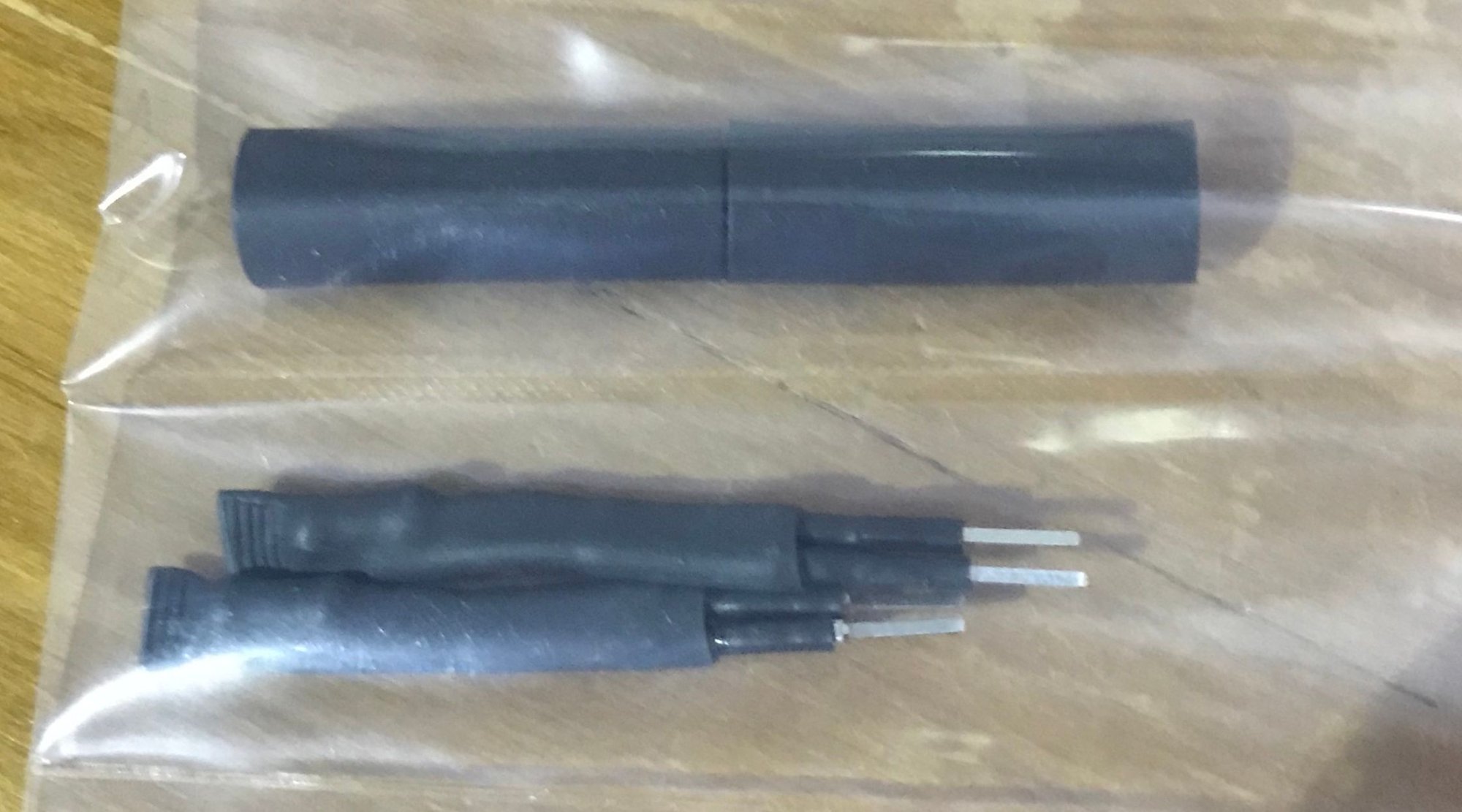

Currently I am running the N14 JCW intake with a foam filter with stock intake piping. I pulled the rubber gasket off the intake pipe that connects to the turbo for a temporary solution. I am piecing together a new intake and jumping out the heaters using the jmtc inlet hose and a NM intake. You can get the resistors from NM to jump out the two heaters.
